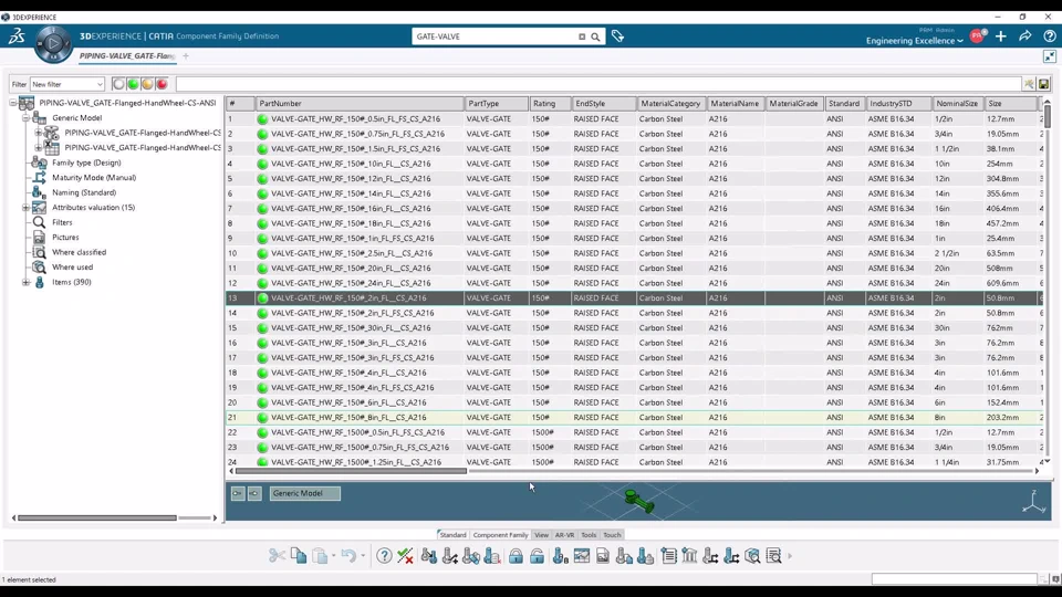

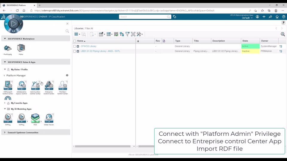

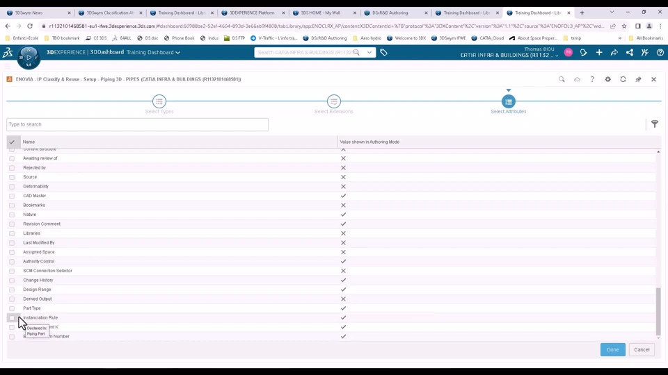

Setup Predicate and Library class attributes
Populate library with Component family resolved parts
Create piping Master Library from Library template
Duplicate CATIA Piping specification to create a new Spec that will use 3D Piping Part in Libraries
Create Piping Material Specification Library and  use it in CATIA Piping Specification Part filters
