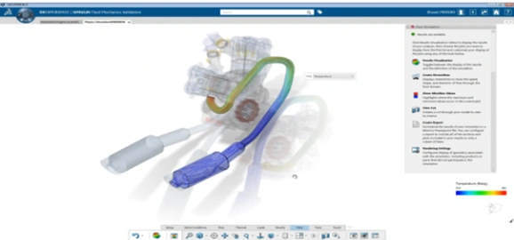

In addition of this, Simulia is proposing also some roles to do complex CFD analysis thanks to Fluid Dynamics Engineer (FMK) ; enables designers and design engineers with the ability to validate and optimize the fluid and thermal performance of their product designs

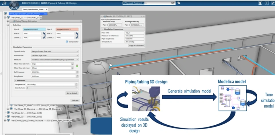

CATIA 3D Piping App - Light integration

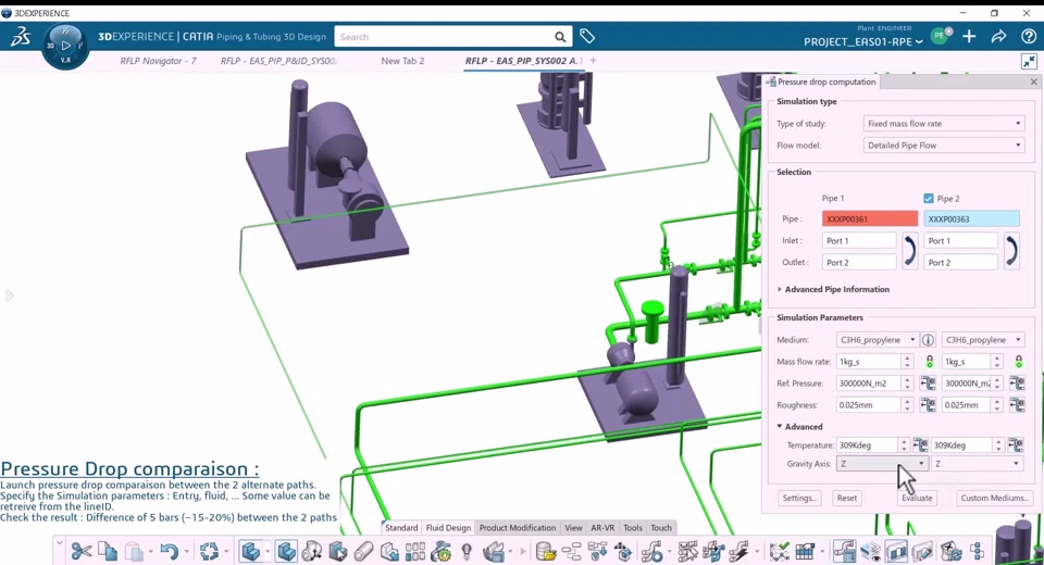

this embeded command available in Piping & Tubing 3D Design App is very limited in term on scope. it is done to compute (and compare) the pressure drop based on a single pipe route (without taking into account any other branch or component. it is used in very early phases to have a rough idea between different routing path alternative. To use it , yo uca nrefer to following
Video
Setup

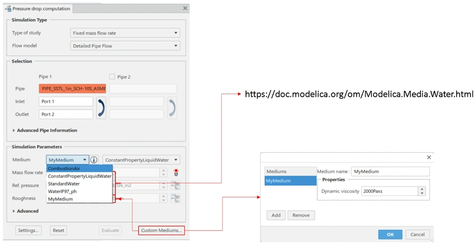

Medium information ;: default medium are provided in OOTB (see: doc : https://doc.modelica.org/om/Modelica.Media.Water.html ) or you can create your ouw one
Pressure can be automatically retreived from lineID if defined on it

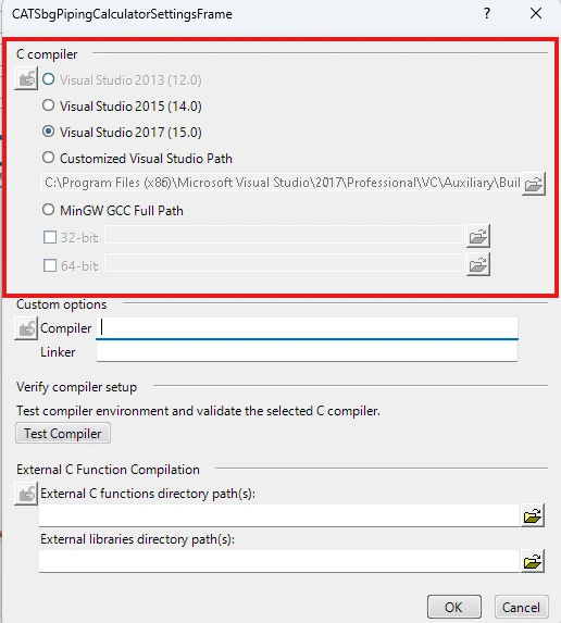

Do not forget to set a compiler in the Setting option in the panel (at the first run, nothing is selected and command fails)

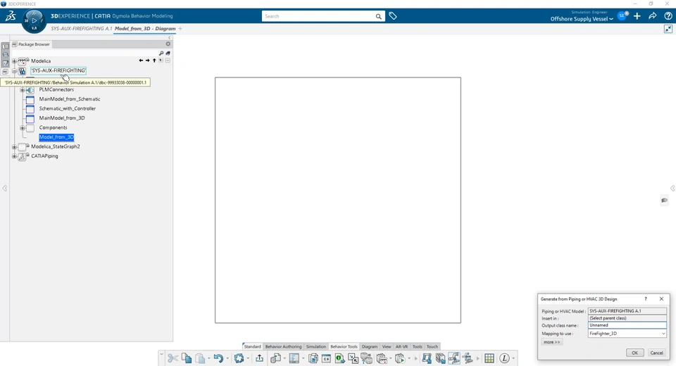

This command is requestion to have Dynamic System Engineer Role (SNK license) in addition to the 3D Piping Design Role
This command allows to create a Dymola model automatically from the 3D piping assembly
then you can add in the Dymola model you probes and constrains and run simulation on it
