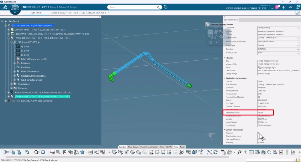

Usecase 1 : single pipe revision
There is no specificities concerning the revision of pipe compare to any other data
warning:
When doing new revision for pipe, it is not recommended to reinstantiate the revised pipe into the assembly because.
- it will not ensure to reroute correctly the links
- the instantiated pipe can't be edited
If for any reason you want anyway to instantiate multiple revision of the same pipe into the assembly, then you must revise the "Equiped tube" assembly or place your tube into a shell product, revise both and insert the revised product
