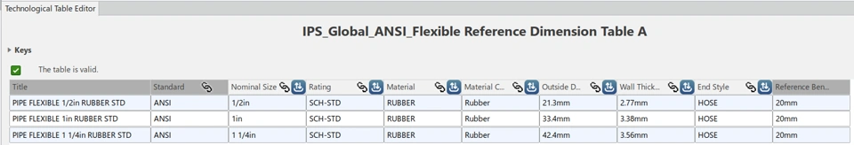

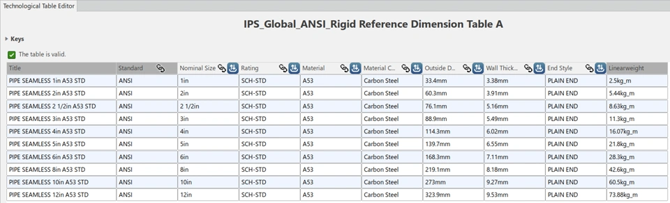

  • 10 Nominal Sizes for Rigid Pipes.
  • 3 Nominal Sizes for Flexible Pipes.

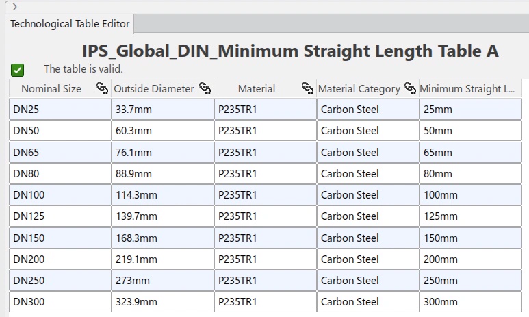

  • Piping Minimum Straight Length to map some attributes of the pipes/tubes with the allowed minimum straight lengths between two bends.

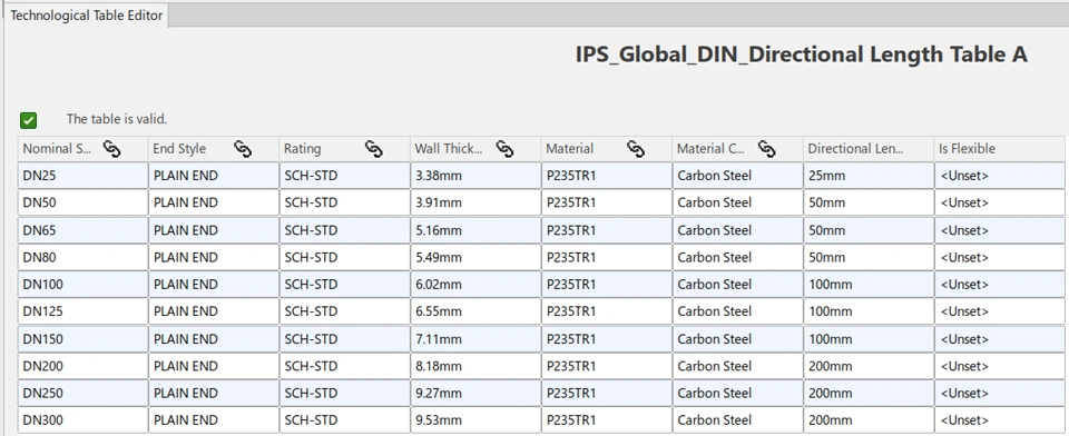

  • Piping Directional Length Table to define the minimum length of the straight routable portion connected to a port.

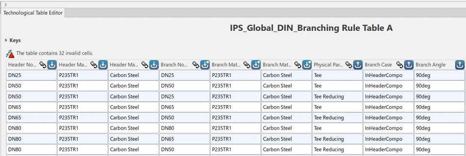

  • Piping Branching Rule Table to automatically manage the Tee junction.

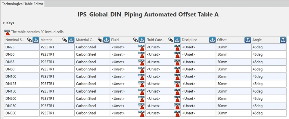

  • Piping Automated Offset Table to define the parameters when using the Automated Offset command.

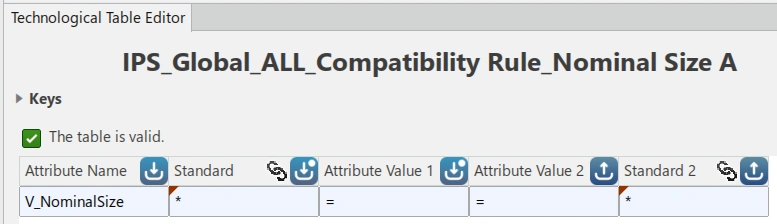

  • Piping Compatibility Rule Table to ensure that when you are placing parts and creating routes, the parts you choose are compatible with one another and with the route.

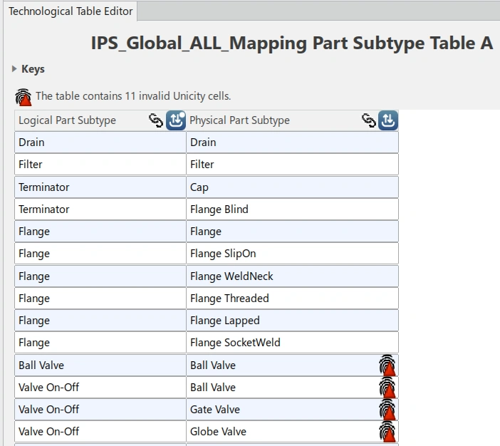

  • Mapping Part Subtype Table to identify for each logical type the corresponding physical type when doing L2P.

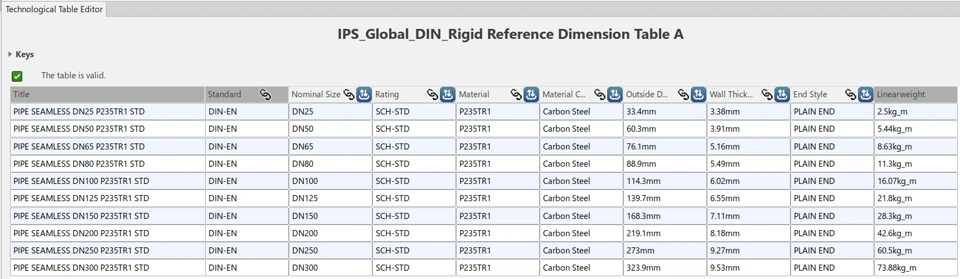

Piping Reference Dimension Table - Rigid

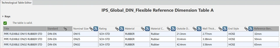

Piping Reference Dimension Table - Flexibles

Piping Minimum Straight Length Table (extract)
Piping Directional Length Table (extract)
Piping Branching Rule Table (extract)

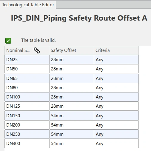

Piping Safety Route Offset Table

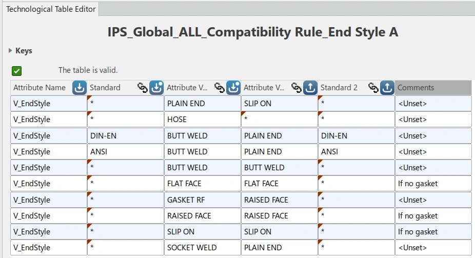

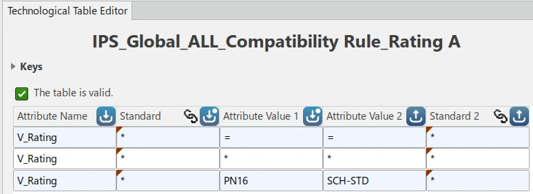

The Compatibility Rule table is used in two ways during part placement:
  • It helps in building a formula to apply on catalog, database, or Parts Filter.
  • It helps in orienting parts correctly.
For instance, when placing a part on a route, it is sufficient to obtain the size value from the document and filter the catalog to find parts with the same size. However, sometimes the part that is being placed needs to have an attribute that does not match the attribute on the part it is being placed against.
An example is when a male end is placed next to a female end - these are dissimilar values and this is where the compatibility design rule comes into play. The text table associated with the design rule is examined to determine which attributes match, and the data source is filtered accordingly.

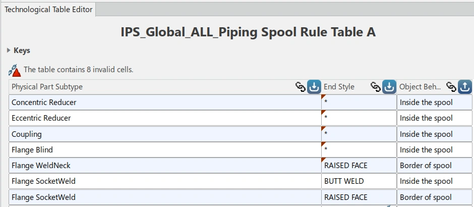

Piping Spool Rule Table (extract)
The Spool Rule table lists three parameters: Part Subtype, End Style and Behavior. The behavior indicates whether a particular combination is to be:
  • Forbidden in spool: the combination is not included in any spool but further navigation to add a part in the spool is stopped.
  • Border of spool: the combination is included in the spool but further navigation to add a part in the spool is stopped.
  • Inside spool: the combination is included in the spool and further navigation to add a part in the spool goes on.

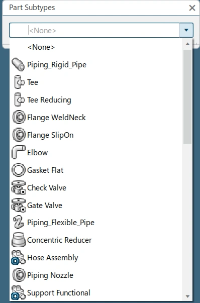

Mapping Part Subtype Table (extract)

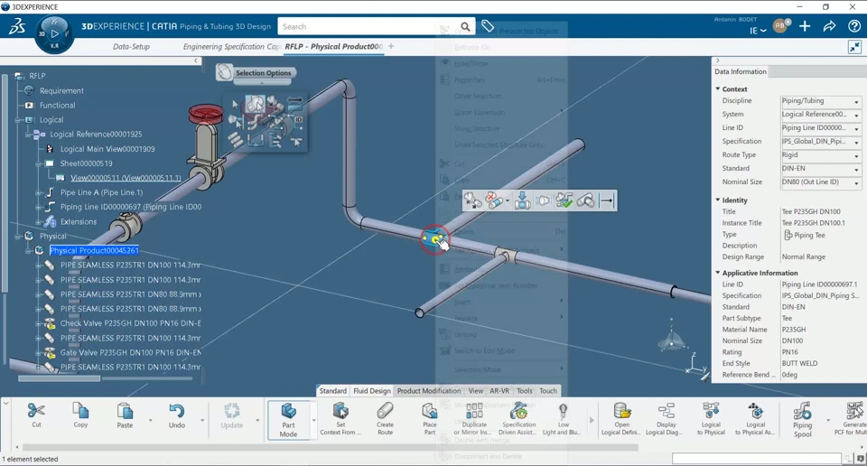

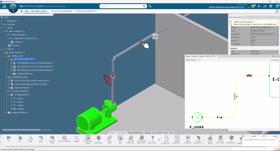

Practice L2P - start from Scratch
Note: In the "3DXML to import for 26x" you will also find the following the L2P model "IPS_Global_Piping-PROJECT1" that contains the final version of the model described in the video, that can be used to verify your design.
