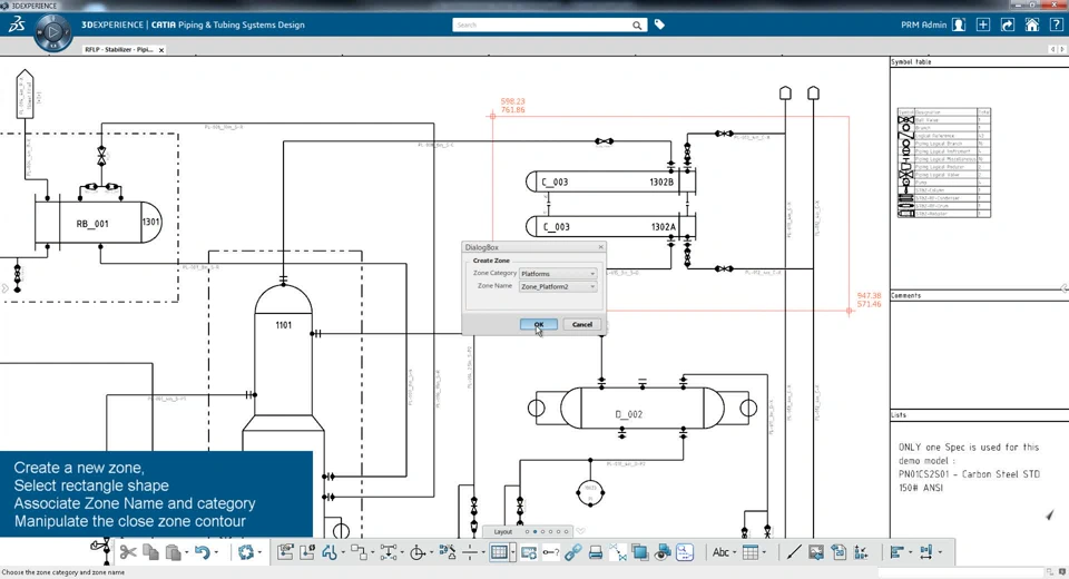

Zone contours
You can define Zone line or contour inside the P&ID
When drawing such element you must asociate to it a Zone category and zone Name.

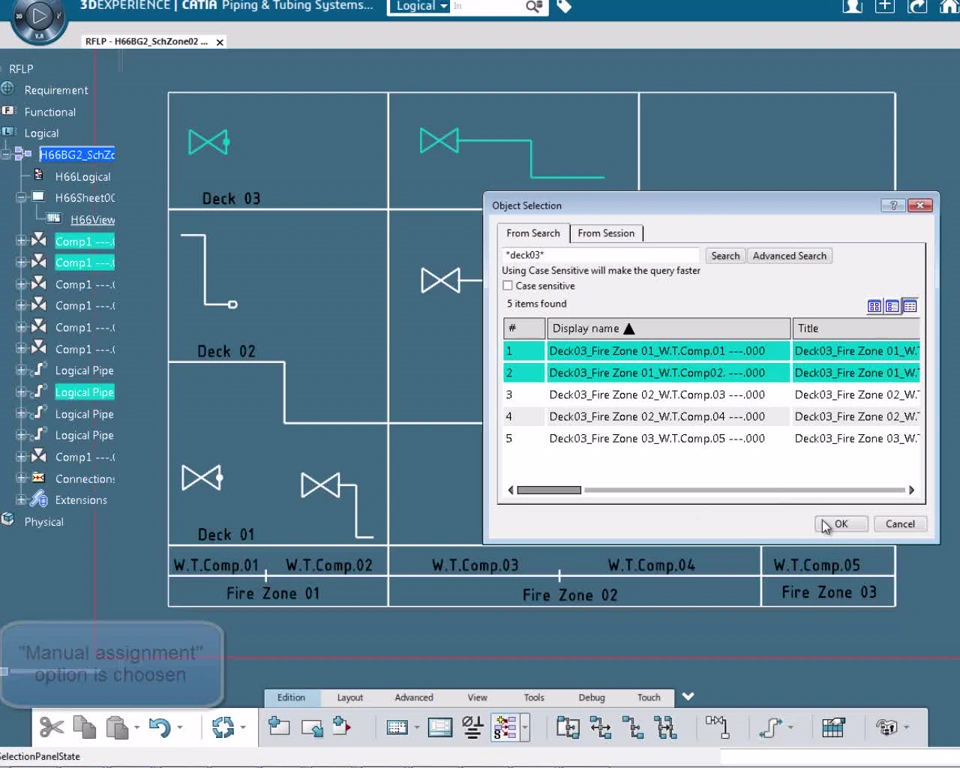

Manual association of components to 3D Space
For manual association you don't need any setup except having created 3D Space object into the datadase
- 3D Space object are usually created inside a GBS : Geographic Breakdown Structure
- the GBS is created using the Space Allocation Application which is part of SAO "Space allocation" Role
- to use the 3DSpace once created, you don't need any specific licences
then you can launch the manual association. the link between the 2 object can be seen in the property panel of the piping component

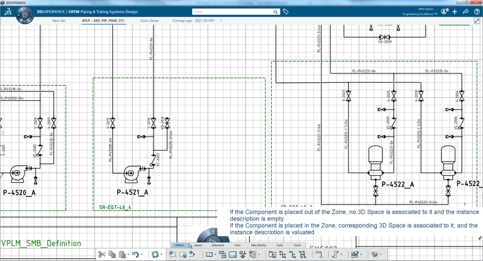

Automatic association of component to 3D Space
System can automatically create a link with the 3D space of the GBS (Geographic Breakdown Structure)
Based on the value set on the Zone contour, system will compute the corresponding 3D Space object through a businees rule
- for close contour it is simple; the Zone name is often equal to 3DSpace name
Application will then create a link between 3D Space and any of the object that are placed/moved inside the corresponding zone contour

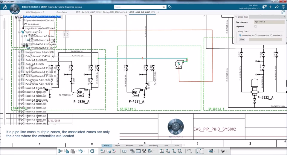

PipeLine association cross multiple Zones:

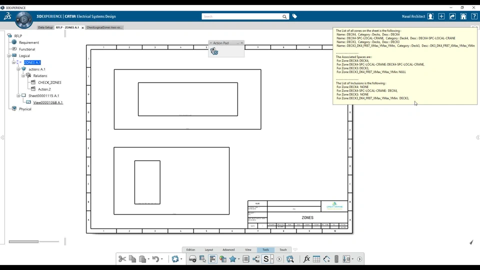

Checks
Zone inclusion consistency can be verified using knowledge checks:

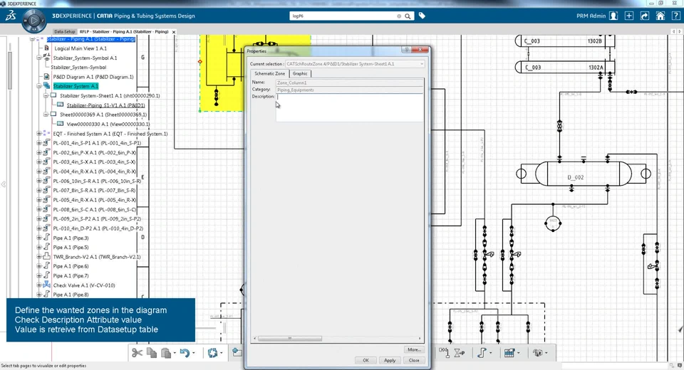

Automatic Attribute valuation
Zone Contour Description
You can modify the Zone list table by adding a second column wit hzone description
in the P&ID, you can set automatically the Zone contour description attribute value from the Zone list table during ZoneCategory/Zone association to contour:
Set component attribute during 3D Space association
when creating the link with the 3D Space, you can modify the value of any attribute of the piping component:
Data setup link :

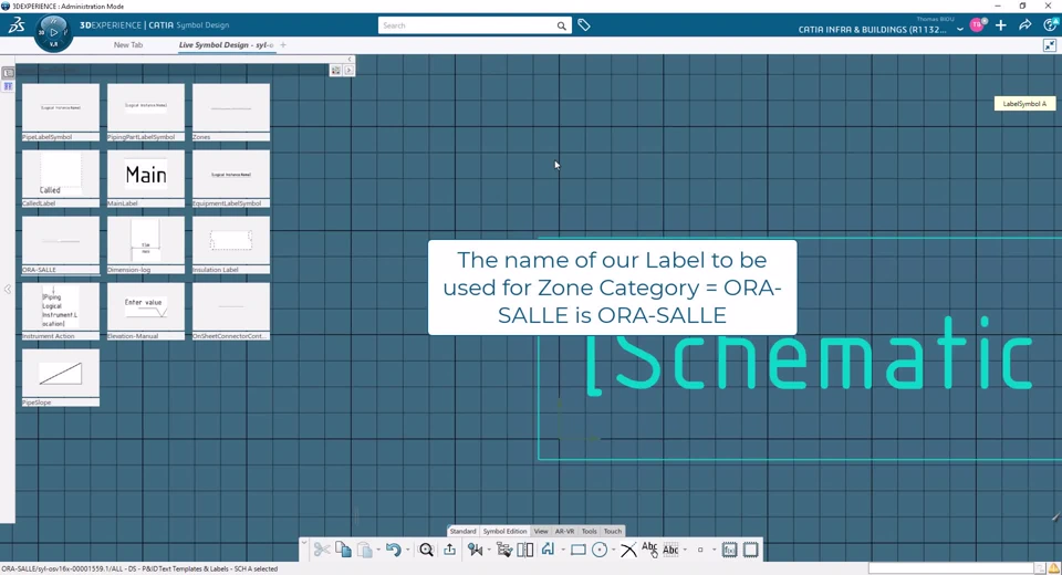

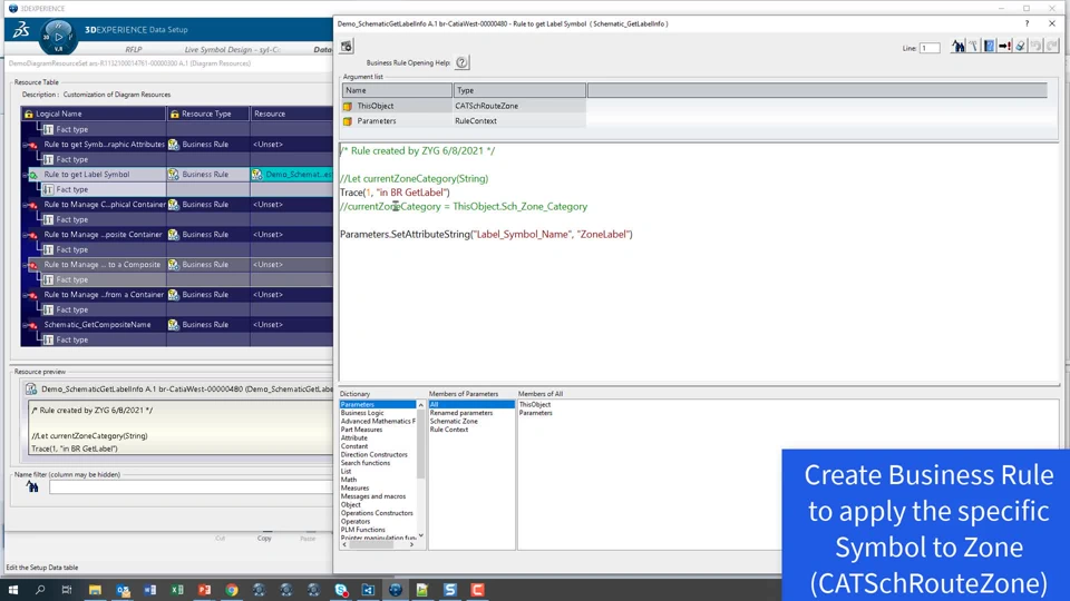

Automatic annotation of zone
Context
Annotation and Label can be automatically inserted when creating the Zone contour
Setup :
- Define you text template or label inside a logical reference
- Attach this Logical Reference to the corresponding resource into datasetup
- define Business rule to trigger which textemplate or label must be inserted depending to criteria
video about automatic text annotation insertion for all Zones:
video about automatic text & label annotation insertion User + Admin part
the label will depends on the Zone category name
Datasetup link :
