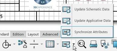

Following command allow to fill the value of these 3 attributes from the LineID to the Object instance in post process mode
