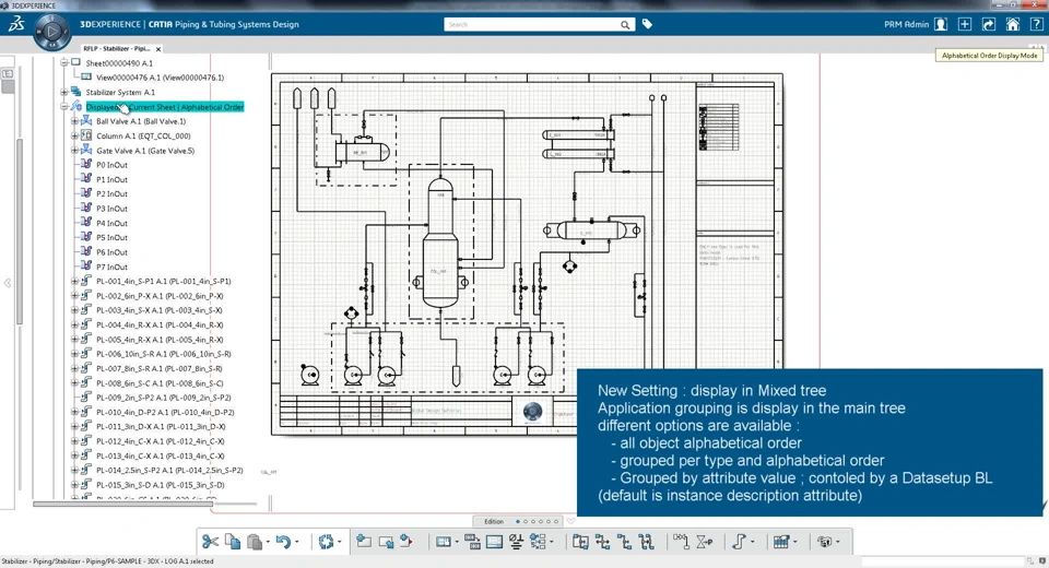

Different tree modes can be display schematic application (Status up to 24x)
standard tree :
- all object are display at the same level

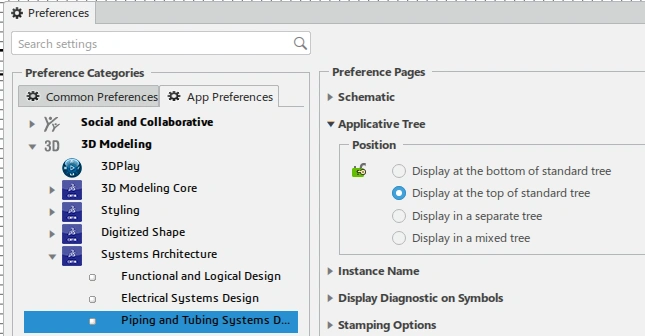

- no grouping node. order can be manage using standard tree order command
Applicatve tree displayed in standard tree (at top or bottom)
- additionnal node in standard tree where object are regrouped per types
- list of types is hard coded
- object that are not part of any o these type are not displayed into this tree

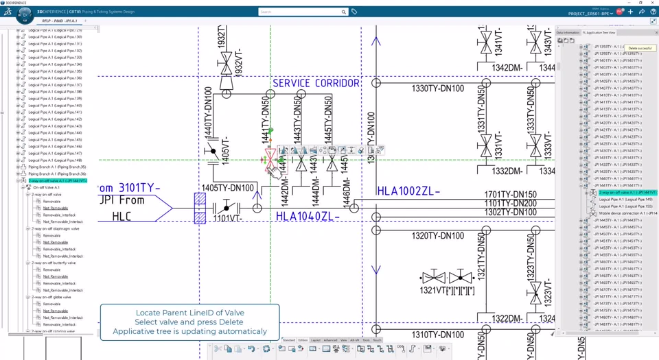

- in the LineID grouping node, object are grouped per parent lineID
Application tree displayed in separeted tree :
- additionnal tree in addition to Standard tree
- object are grouped per types
- object are grouped per parent lineID
- diferent filter mode (object "in"/"not in" curent sheet, ....
Applicative tree displayed in mixed tree
- replace standard tree
- object that are not part of any o these types are displayed all are the same level like in the standard tree
- per attributes
- object "in"/"not in" curent sheet, ....
