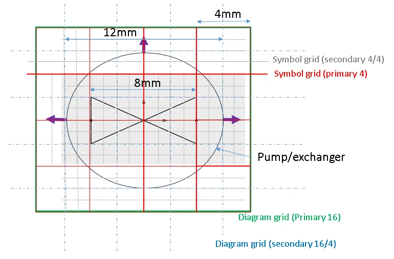

Diagram grid:
The reference Input is the minimum distance between 2 lines of the grid
The grid must fit to Symbol size to match with symbol ports

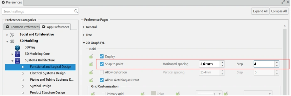

  • If 4mm :
    • Set Grid in Functional and Logical Design accordingly
    • Spacing 40, step 10 (40/10=4mm)
    • Or  Spacing 20, step 5 (20/5=4mm)
    • Or  spacing 16 step 4 (16/4=4mm)
Set the wanted values in Preference/System Architecture/Functional and Logical Design / 2D Graph FL / Grid
Symbol Grid

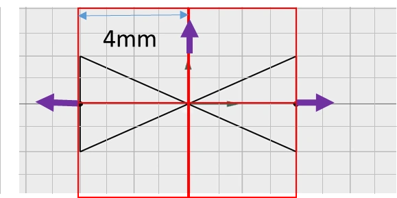

  • if we take the same value as previously : 4mm

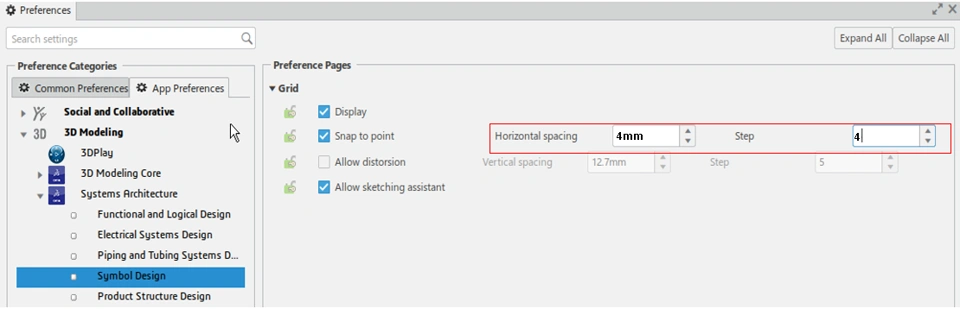

    • Set Grid in Symbol grid with Horizontal spacing = to the Diagram mini grid (4mm in our case).à this will define the possible position for the ports for all symbol
    • Define the amount of step , ex : equal to spacing to have geometrical grid 1mm
      • Spacing 4, step 4 (4/4 = 1mm)
Note : the important is that your ports are fitting to the Diagram gid
  • Vertical ports are always on a red vertical grid line
  • Horizontal ports are always on a red horizontal line
 Set the wanted values in Preference / System Architecture / Symbol Design / Grid
