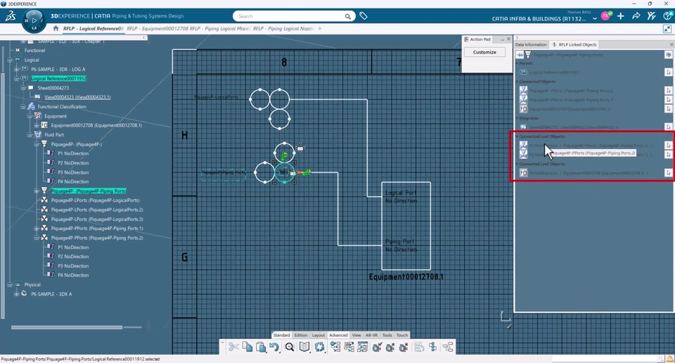

You may want to replace an existing object by a new one
for exemple before 26x , for Nozzle , we where using "Logical Piping Miscelaneous" object. Now in 26x we have a dedicated object "Piping Nozzle" --> we create a new object with same symbol and replace it in all our P&ID
The following video is generic for  replace command for any type of objects
  • replace a valve by another one
  • replace a eccentric reducer by a concentric reducer
Comment
Port Type, name and Flow direction is important. they must be equale between the replaced object and the new object
Video
following video is based on a non industrial case (using object type that does't match symbol representation)  it is just to illustrate the principle on connectivity management between objects
