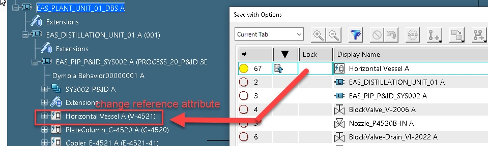

Attribute modification & save
An attribute value that is defined at the reference level is common to all instances.
  • Modifying it will impact the all instances.
  • When saving only the reference is considered as modified

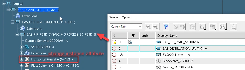

An attribute value that is defined at the instance level is specific to each instance.
  • Modifying it will not impact the other instances
  • When saving the reference is not considered as modified but the Parent product will be

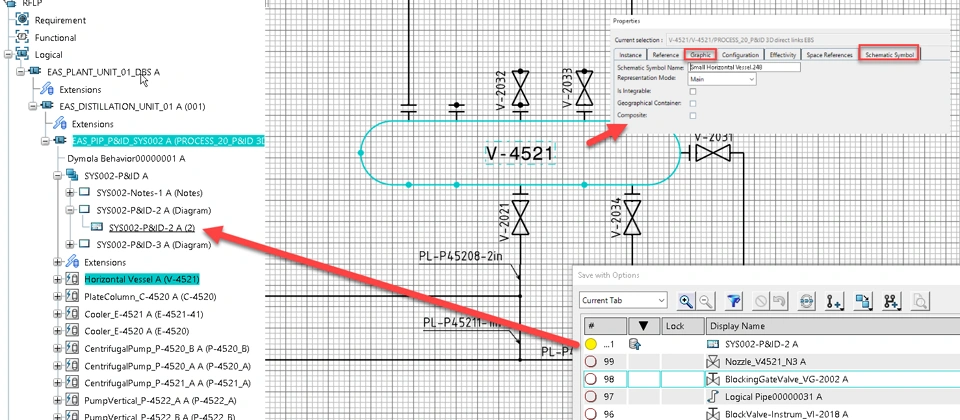

Symbole in view modification & save
Modifying a property on the symbol rep iin the sheet/view, (like line type, or name..) (Properties tab : Graphic & Schematic Symbol)
  • Modify the View object
