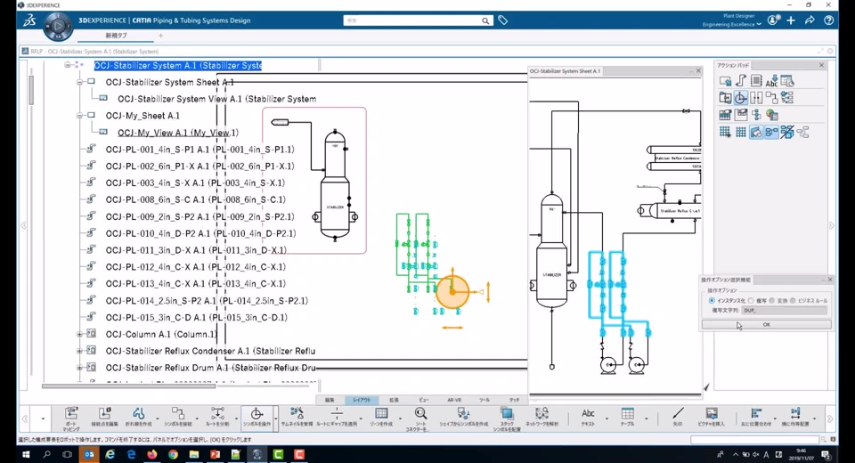

Different Modes :
  • Instantiate = copy and create new instances
  • Duplicate = copy and create new references
  • Transform = move inside the same sheet
  • Business Rules = define in the rule the mode to used according object types, attributes...

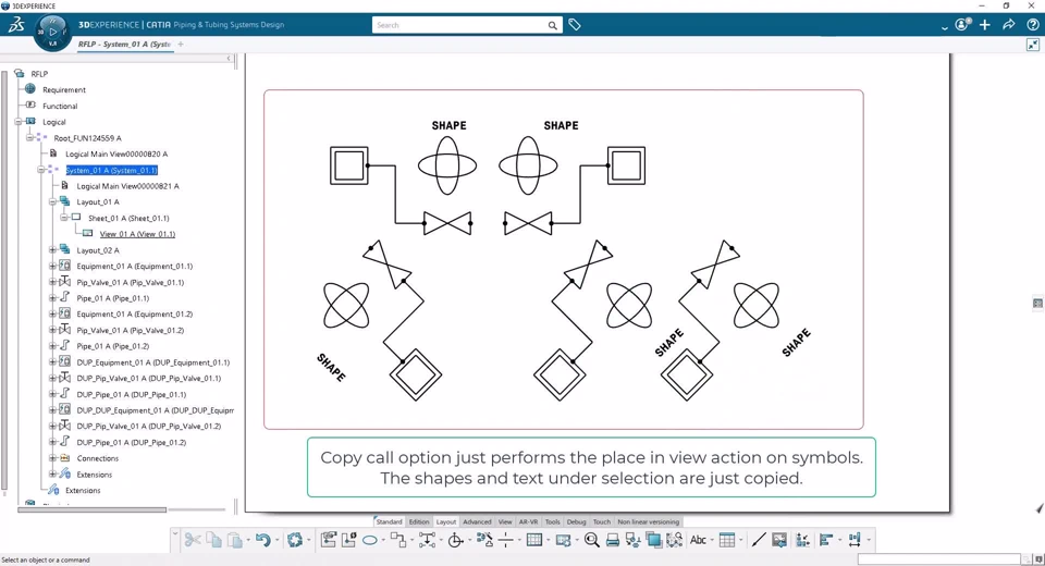

  • Copy-Call = place in view
illustrate the different mode of network duplication

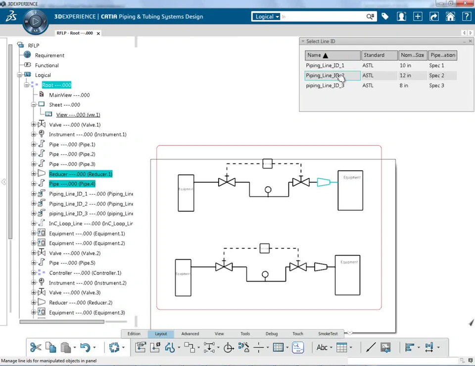

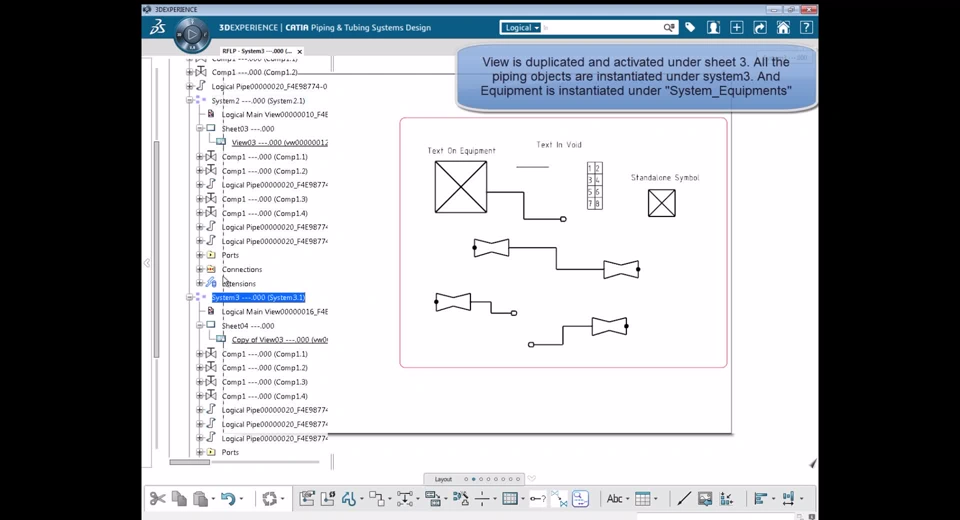

Multi sheets:
LineID transfer :
automatic lineID transfer for the duplicated data

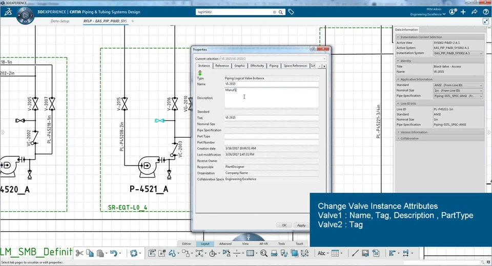

Openess - datasetup
Copy attributes to the duplicated data
See datasetup section:

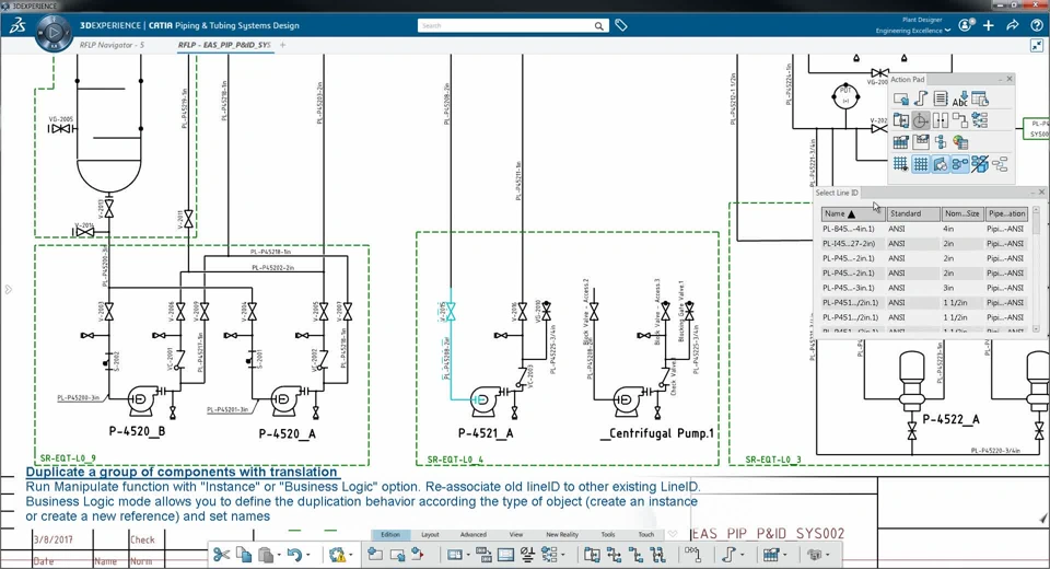

Drive duplication mode (duplication, instanciation, Place In view)  using Business Rule:
