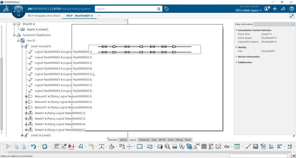

Partial loading
Open P&ID sheet without loading components
When working with very large Data with lot of diagram sheets in the same P&ID (logical Reference), it could be needed to be able to load only one sheet with the obejct that are inside this P&ID. here is the process to do it
Note : general remark  : it is recommended to not work with lot's of sheet in the same P&ID. it is recommended to split in multiple P&ID (Log reference) with few sheet. this will
  • improve the overall performances of the system
  • facilitate user navigation (less object in tree)
  • facilitate concurent engineering and lifecycle management

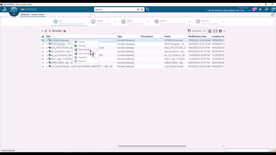

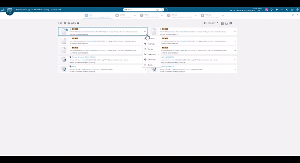

Open P&ID from 3DMarkup widget
When working with 3DMarkup on a 3D part or Product, you can directly drag & drop the the Part/product object from 3DMarkup widget (web App) to 3DEXPerience CATIA Native Client to edit it
But for P&Id it is a little different. on P&ID or other Schematic document done with CATIA, the object which is used by 3DMarkup is a "Sheet" and not a Logical reference. Because you cannot open a P&ID "Sheet" objects individually in the Native Client to edit it, you must retreive  it parent Logical reference to be able to drag&drop it in the 3DEXPErience Native Client to edit it.

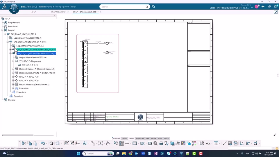

Open session in context of working in ITEM mode
When working in ITEM mode, system will create links between 2D Schematic Object of the Diagram breakdown structure (DBS) and "Item" from the System Breakdown structure (SBS)
to ensure that all the information are accessible by the app, you must open in the same session the 2 Product structures that contain the system definition on which you are working on
here is a video to illustrate how to prepare this session
