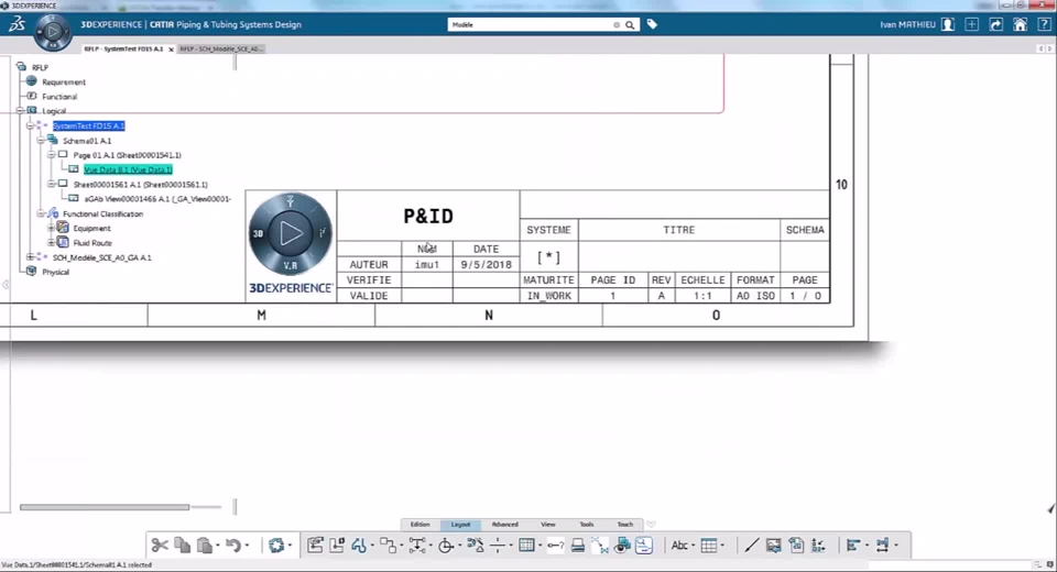

Layer usage - user side
Exemple of layer usage to store in P&ID for multi langage information
note: layer information is store at the View level--> if you copy the view the layeur information is maintain for the elements represented in the view
Layer Usage Admin side
Detailled video about how to :
  • define different layers and filters
  • use the search to found text and place them in a layer
  • filter the P&ID display using filters based on layers
