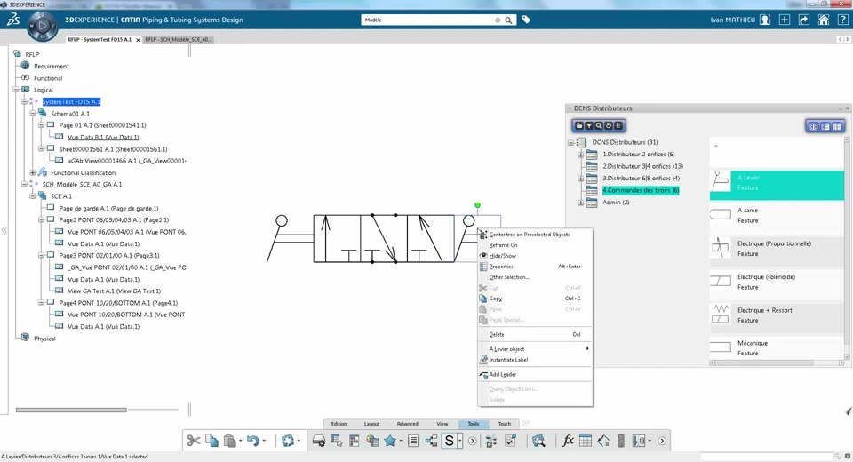

Labels can be defined in 2 different ways depending on the way they will be placed
  • If label will be placed manually then they must be defined into Drafting application using "2D Component"+"Label" in drawing object

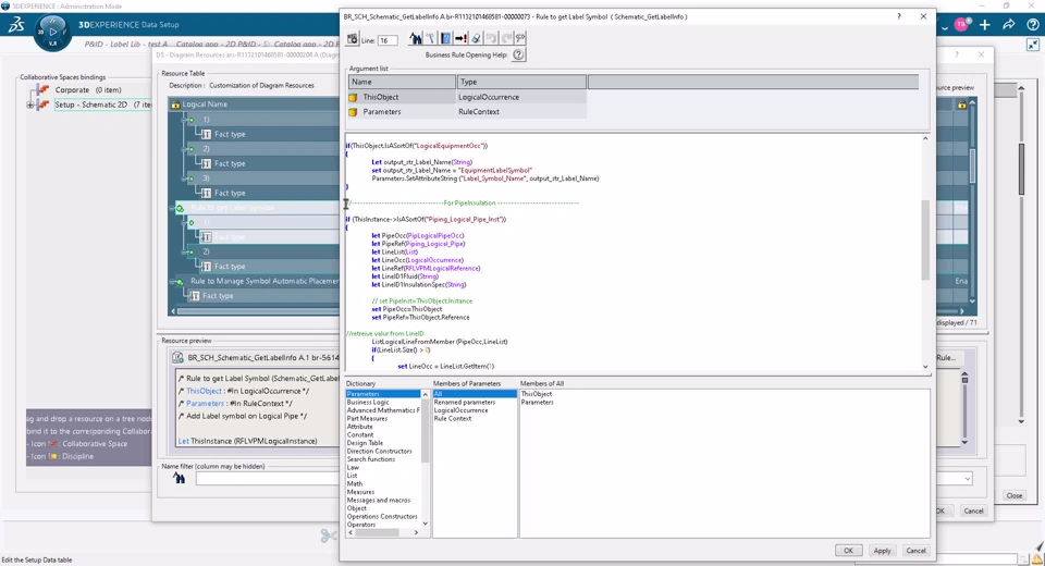

  • If label will be placed automatically using datasetup Business Rule then they must be defined into symbol editor inside a  "Symbol" in a "logical reference" object
We will see the 2 exemples bellow.
Define Manual Label : slope Label exemple
Define "slope" label to be placed manualy from catalog

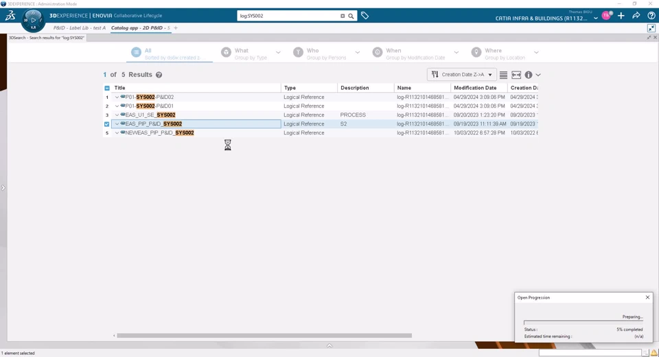

Define Automatic Label: slope Label exemple
Adjust above "slope" label and define setup to be able to place automaticaly this label base on pipe parent lineID attribute (here description but can be any OOTB or custom attribute)

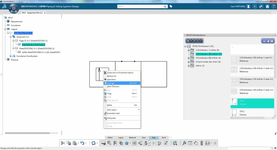

Manipulate Labels
Scale follow symbol:
Flip:
Setup :
