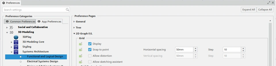

Diagram grid:
you must ensure that the grid secondary spacing is smaller enough to allow that any symbol port match to it

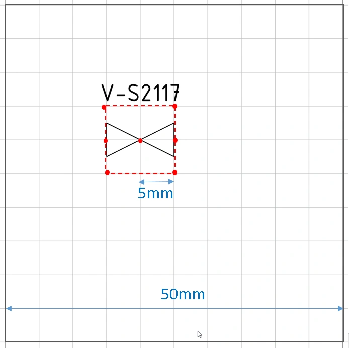

so if we consider that the elementary minimum size for P&ID symbol is 5mm then we can define the diagram grid as follow:
20mm / 4 step or 100mm / 20 step
in red the possible position of the port of the symbol to match Diagram grid

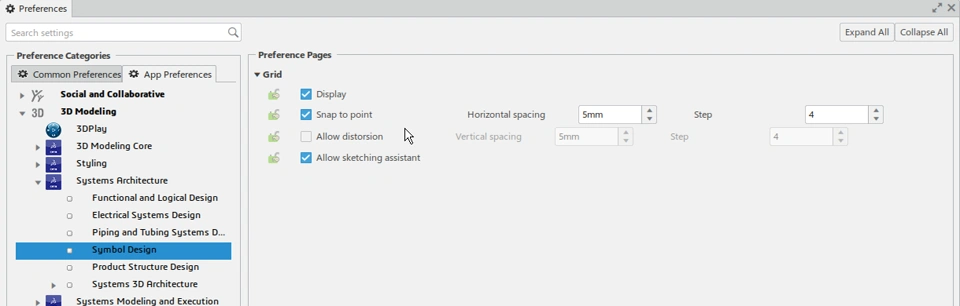

Symbol grid :

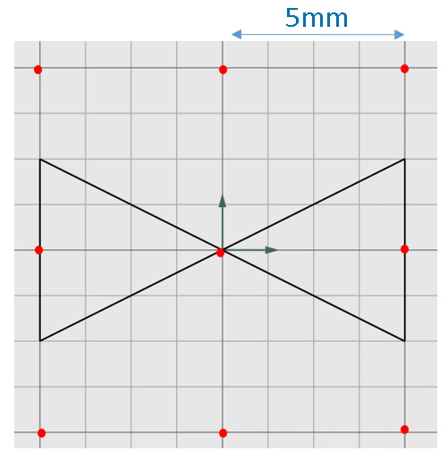

for the above exemple the minimum grid (secondary grid )of the diagram will become the primary grid of the symbol
so 5mm and step number will be generaly a pair value 4 --> symbol grid is 10mm with 4 step --> grid spacing = 10/4=2.5mm
Port must be always placed on the primary grid in symbol design. if it is not possible , then you must adjust the Diagram view Grid

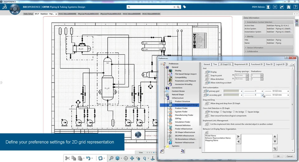

Grid display
Define grid display :
- line Type, thickness and Color
