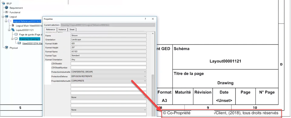

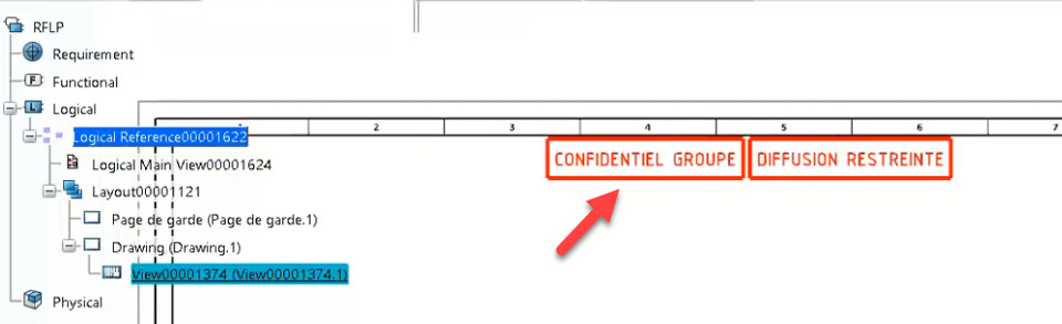

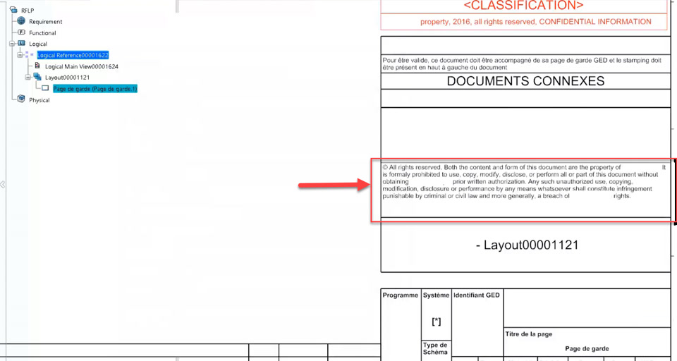

You can use some attribute of the sheet object to control the automatic insersion of Stamping, watermark or special condition text
Define Stamping
The principle is similar to the one for automatic part placement of Text template and label.

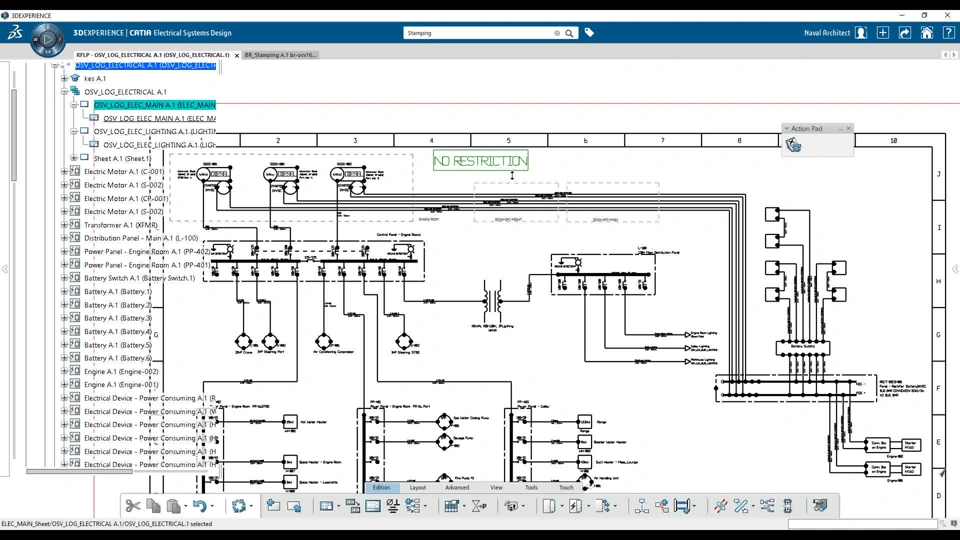

you have a logical reference that contains the list of text templates / labels that you attach to a ressource in the diagram ressource set in datasetup App
you have a Business rule inside the same Diagram resource set where you define the condition to apply the Texts / label and their position inside the diagram. usualy in the rule we check one attribute of an object and according the value we determine with text must be placed. you can place in tha tway as much text you want
this involving 2 different ressources than the one use for standard text template and label for components placement or pipe routing
