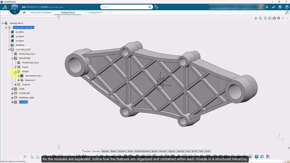

Part Design Plus: Modules interfaces in Part Design Plus unlocks the ability to create and manage multiple solid geometry alternatives within a single managed structure eliminating the need for separate files per variant. A ribbed structure and a solid structure, a single bolt hole pattern and a four-bolt hole pattern each becomes a formal alternative module under the same parent, sharing the same interface contract and switchable in one action without touching any upstream or downstream geometry. This is the most immediate value addition, variant management that was previously handled through file duplication is now a controlled, reversible operation inside one part.
Beyond alternatives, Modules and Interfaces adds a formal structure to solid feature design that Part Design Plus does not have by default. Packaging solid feature clusters into named geometry modules with defined input and output interfaces allows geometry to be driven from external parameters and references, and design changes to propagate automatically across all instances. Input interfaces make the module adaptable to any part context, accepting a support face, a sketch plane, or a dimension value and rebuilding the solid geometry automatically. Output interfaces publish symbolic references, derived planes, axes, and parameters that downstream modules consume as stable named connections, keeping the design intact even when upstream geometry changes.

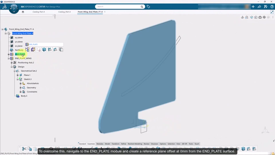

However, when connecting modules in Part Design Plus, directly referencing solid BRep geometry such as a face or edge from one module to another triggers a Feature Definition Error, preventing the downstream module from building as intended.
Here, you can see how to resolve this by publishing a symbolic reference such as an offset plane or parameter as an output interface from the upstream module and consuming it as an input interface in the downstream module. This approach allows all dependent geometry to update automatically without crossing the BRep boundary.
