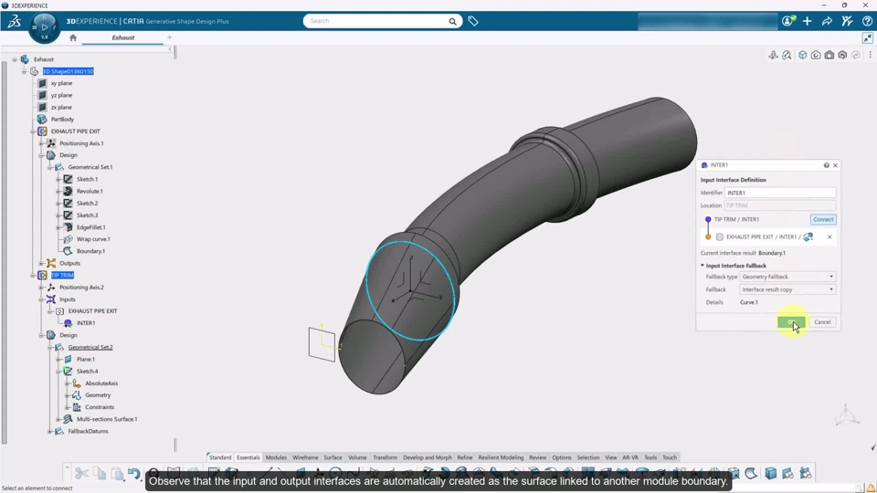

In Generative Shape Design Plus, Modules and Interfaces allow each Geometrical Set to be encapsulated in a watertight module with formally defined input and output interfaces that connect it to other Geometrical Sets.

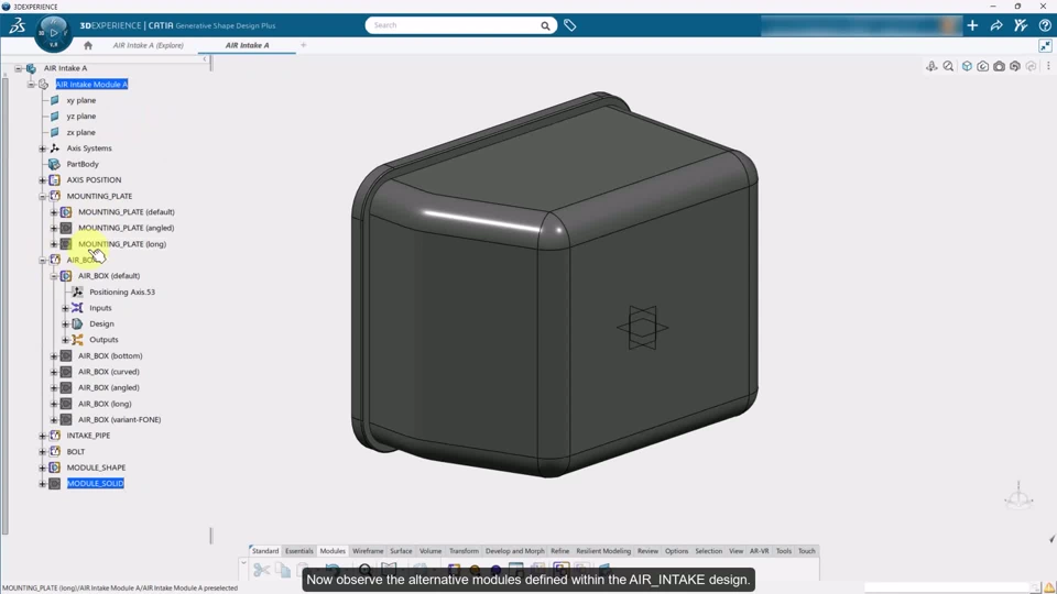

Multiple alternatives can be generated, each containing a different version of surfaces and design features, while the interface connections to surrounding modules remain unchanged. Switching between alternatives requires just one action, and the connections never break, accelerating design exploration and enhancing the overall robustness of the model.
Modules and Interfaces in Generative Shape Design Plus allow designers to package each Geometrical Set containing surfaces and construction features into a named, watertight module. Each module defines formally defined input and output interfaces that connect it seamlessly to surrounding Geometrical Sets (Modules).

Generative Shape Design Plus: Modules and Interfaces in Generative Shape Design Plus unlocks the ability to create and manage multiple surface geometry alternatives within a single managed structure eliminating the need for separate Geometrical Sets or files per design variant. A sharp leading edge and a blended leading edge, a standard end cap and an aerodynamic end cap, each becomes a formal alternative module under the same parent Geometrical Set, sharing the same interface contract and switchable in one action without affecting any surrounding surface geometry. Unlike Part Design Plus, GSD+ supports cross-module surface references freely meaning alternatives can consume surfaces, curves, and wireframe geometry directly from upstream modules without restriction, making the switching experience seamless and the interface contract more powerful.

Here, with the help of Modules and Interfaces in CATIA 3DEXPERIENCE, each Geometrical Set is packaged into a watertight module with formally defined input and output interfaces that connect it to surrounding modules. Unlike Part Design Plus, Generative Shape Design Plus supports cross-module surface references freely, a surface, curve, or wireframe element from one module can be directly used as an input interface in another without restrictions. Alternative modules allow different surface solutions to coexist under the same parent, and switching between them requires just one action, with all interface connections remaining intact.
Play the video to watch how Modules and Interfaces improve model robustness in Generative Shape Design Plus.
Play the video to watch how to create modules and link them to other modules seamlessly.
