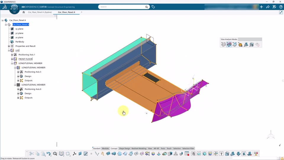

Scenario: In a Concept Structure Engineering design process, when developing structural components such as cross members, designers typically explore multiple geometric solutions in separate files with no formal connection between them, making comparison, validation, and handoff for meshing a slow and disconnected process.
Here, with the help of Modules and Interfaces in CATIA 3DEXPERIENCE, the cross member design is packaged into named modules with formally defined input and output interfaces. Alternative modules are created for each structural variant, switchable in one action without affecting surrounding geometry. Output interfaces highlight the published surfaces directly in the model, giving immediate visual confirmation of what geometry is passed downstream.
