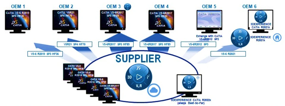

Use the CATIA V5 POWER'BY capability to support multiple releases of CATIA V5 to enable suppliers and OEM collaboration.
In the 3DEXPERIENCE, multiple release support for CATIA V5 POWER'BY (Collaborative Designer for CATIA V5) allows suppliers to work with several OEMs matching their data format specifications.
Working on a single platform for all activities helps suppliers facilitate re-use and traceability across all their projects. It also reduces cost of ownership.
Suppliers need to connect their CATIA V5 to the 3DEXPERIENCE platform for working with OEMs and sharing the accurate product versions with respective OEMs.

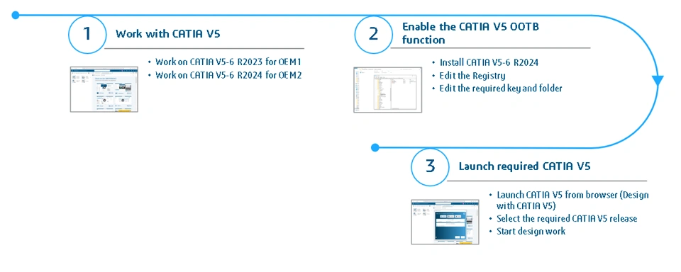

Managing multiple releases CATIA V5 environment on 3DEXPERIENCE Platform
Here are the steps to follow:

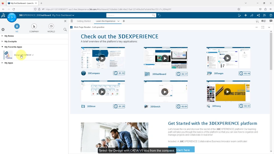

Step 1: Launch CATIA V5

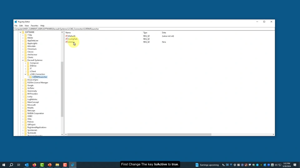

Step 2: Change the values in Registry Editor

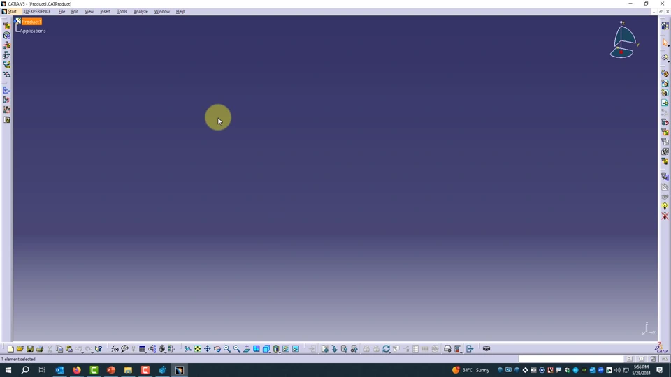

Step 3: Launch and observe different CATIA V5 versions from the same 3DEXPERIENCE platform

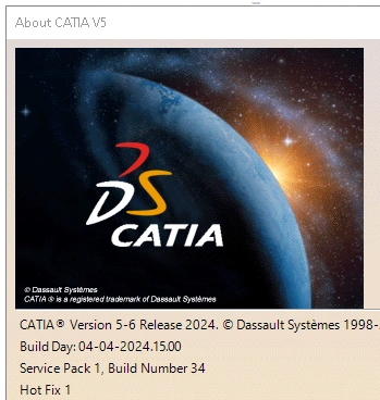

Ensure that you have installed the required service pack and hot fix along with the CATIA V5 release for proper connection with the 3DEXPEIENCE platform.
Get information about CATIA V5 release by selecting the About CATIA V5 option from Help.
