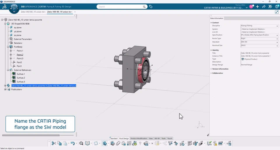

Equiment Case
Piping Part Case
Reuse Solidworks Flange Part geometry to create the Piping Flange containing all necessary added information to have the part working with 3DEXP CATIA Piping 3D App .
This practice will allows you to have the CATIA Piping Part link wit hthe Solidworks model so in case of SW model change the piping part can be easily/automatically updated (thanks to the contextual links beween the 2 models
If you don't want to have the link bewteen the 2 models, then just copy /past as reslt the 3D SW geometry into the CATIA part
