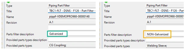

Proposal
The proposal is to use different filters in the specification as follow with description of galvanization done on
V_SpecDescription attribute
The Galvanization will be defined on the filter custom attribute :

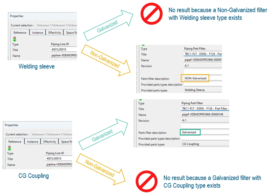

Then the business rule "Compute the List of Additional Specification to be used depending of the context (CATPiping_OP_AddedSpecsAndResourceFilteringParams)" is used to choose the right filter result.
If there is no criteria corresponding to galvanization by filter on one type, the results of all filters will be used.
Demonstration
To sum up the logic of the BR :
  • Check if the part placed is in a predefined list (List done to improve performance)
  • Check if the specification is part of a predefined list
  • If yes
    • Check if there is a least one filter for the input type with attribute : "Galvanized" or "NON-Galvanized"
      • If yes
        • Take only the result of the filter corresponding to the DSKGalvanized attribute from line ID
      • If no
        • results from filter without filter criteria

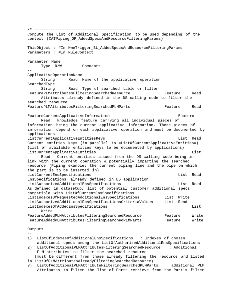

How to setup ?
The business rule "Compute the List of Additional Specification to be used depending of the context (CATPiping_OP_AddedSpecsAndResourceFilteringParams)" in Piping Specification Resource
has to be defined with this code :
ThisObject : #In KweTrigger_BL_AddedSpecsAndResourceFilteringParams
Parameters : #In RuleContext

/* Declarations for BL Outputs : additional PLM attributes to filter searched resource
AND/OR indexes of customer additional ens specifications to filter searched resource */
let FeatureAddedPLMAttributesFilteringSearchedResource (Feature)
let FeatureAddedPLMAttributesFilteringSearchedPLMParts (Feature)
let ListIndexesOfAddedEnsSpecifications (List)
let ListOfAdditionalPLMAttributeFilteringSearchedPLMParts(List)
let i (Integer)
let j (Integer)
let posX(Real)
let posY(Real)
let posZ(Real)
let pos(Real)
let lineFluid(String)
let index(Integer)
let logValveOcc (PipLogicalValveOcc)
let typesList(List)

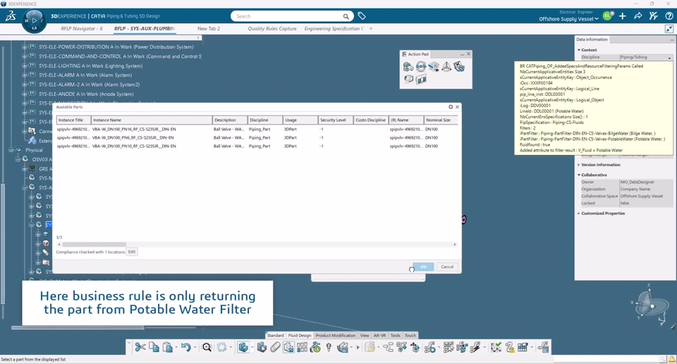

Scenario 2 : Choose specification filter object by LineID Fluid Criteria
Need
The need is to be able to define different resulting list of valves on the same specification based on fluid criteria coming from line ID .
For example, defining a different list of valves for
  • Potable Water
  • Bilge water

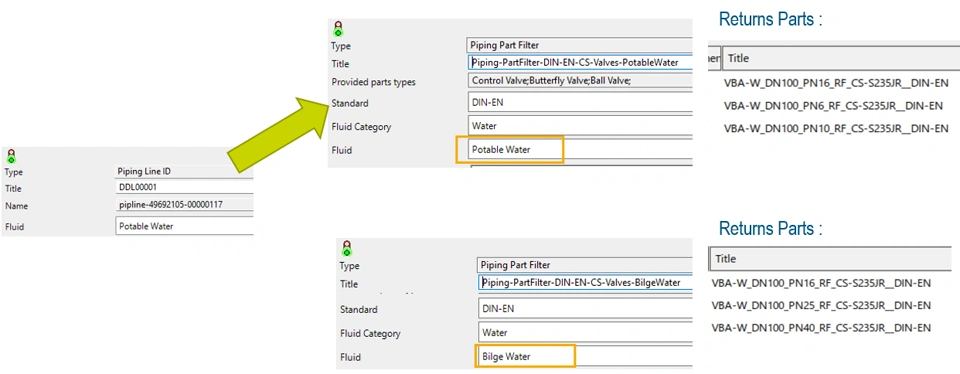

Proposal
The proposal is to use 2 different filters in the 1 specification as follow
with the corresponding results based on Fluid.

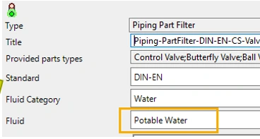

The fluid will be defined on the filter attribute :
If there is no filter corresponding to the fluid defined in the line ID, the results of all filters will be used.
Demonstration
in the demonstration, 2 filters are defined as follow :
let i (Integer)
let j (Integer)
let posX(Real)
let posY(Real)
let posZ(Real)
let pos(Real)
lineFluid=""
let debug(Boolean)
debug=False

            let fluidfound(Boolean)
            fluidfound=False
            i = 1
            for i while i <= filters.Size()
                set ContentObject = filters.GetItem(i)
                if (NULL <> ContentObject)
                    set iPartFilter = ContentObject
                    if(debug)
                        Notify("iPartFilter : # (#, #)", iPartFilter.Name, iPartFilter.V_Fluid, iPartFilter.V_ProvidedPartTypes)
                    if(iPartFilter.V_Fluid == lineFluid)
                        fluidfound=True
                        Notify("fluidfound : #", fluidfound)

                /* **************************** Add Attributes for filtering Resources ********************* */
                set FeatureAddedPLMAttributesFilteringSearchedResource = Parameters->GetAttributeObject("FeatureAddedPLMAttributesFilteringSearchedResource")
                FeatureAddedPLMAttributesFilteringSearchedResource->SetAttributeString("V_Fluid",lineFluid)
                Notify("Added attribute to Valva filter result : V_Fluid = #",lineFluid)
