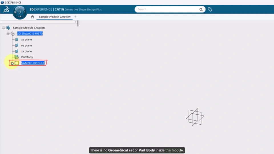

Types of Modules
The modules are classified into types based on their content. There are rules for the type of content that is allowed in these modules.
There are three types of modules:
  • Structure module: A module that contains submodules. You can’t insert geometric or parametric features in this type of module.
  • Geometry module: A module that contains geometric or parametric features (including their sets). You can’t insert submodules in this type of module.
  • Undefined module: An empty module without any content. The type of the first content inserted in this module defines it as a structure module or geometry module.
All the types of modules contain a positioning axis and can contain the interfaces (input and output).
You cannot connect an input interface with an output interface of the same module.

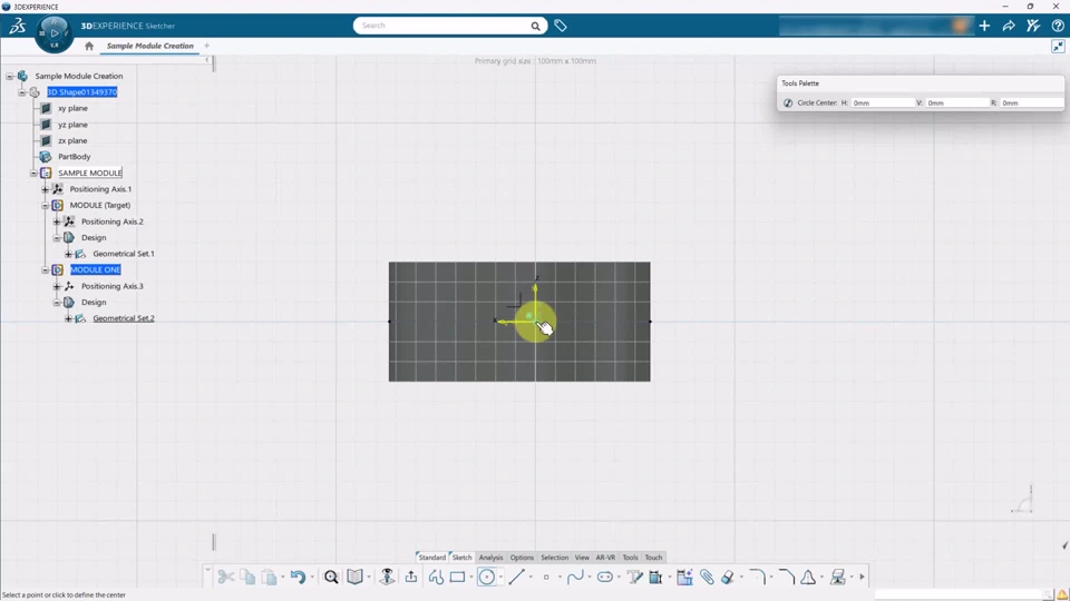

Use Case: Smarter Reuse for Robust Design Workflows
Scenario: In a design process, when you are working on a complex part or assembly with repeating feature clusters, managing multiple instances manually becomes time-consuming and error-prone. Any design change requires updating each instance separately, leading to inconsistencies across the model.
Here, with the help of Modules and Interfaces in CATIA 3DEXPERIENCE, you can package those feature clusters into named, reusable modules with formally defined inputs and outputs, allowing a single change to propagate automatically across all instances.
Play the video to watch how to create the structure modules and the geometrical module within them.
Play the video to watch how to create the modules and interfaces.
