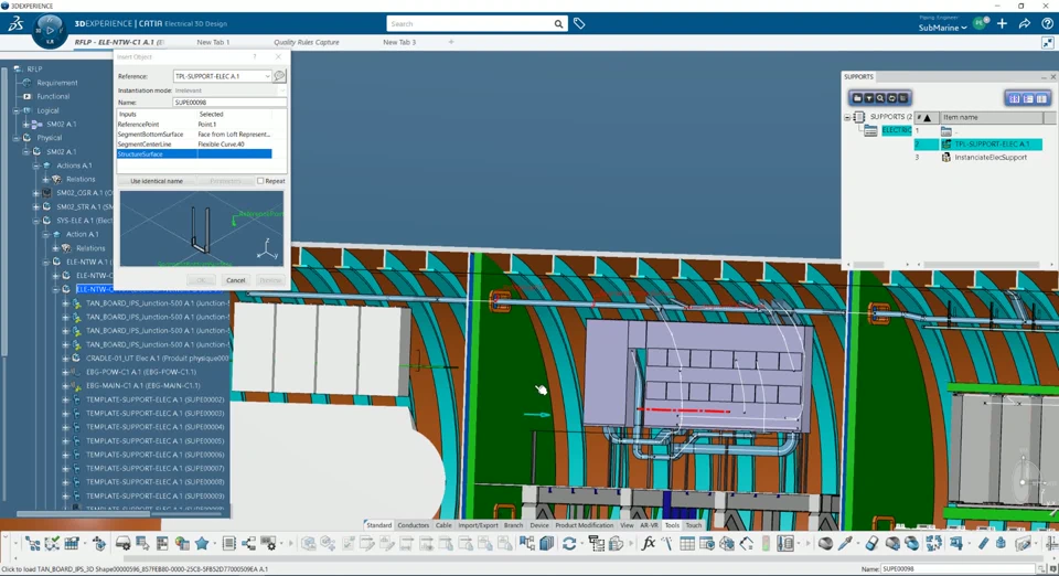

This Template allows to place Electrical Support in the context of the cableway and the structure :

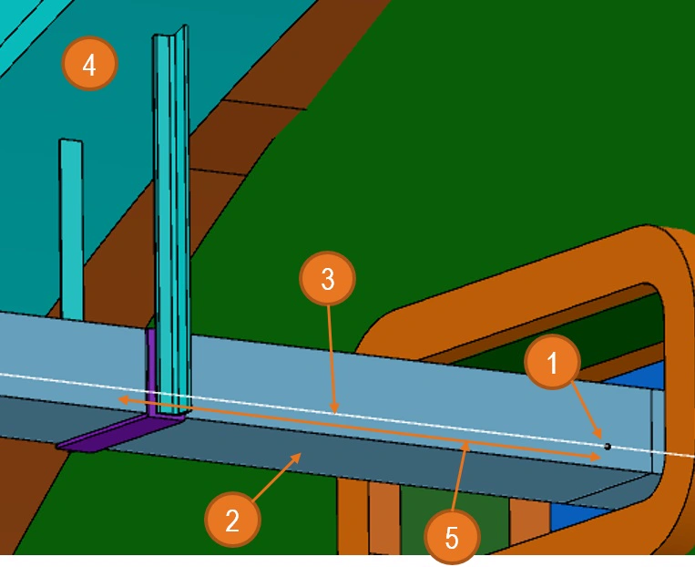

Inputs :
  1. ReferencePoint : Reference point on cableway curve to define the starting point of the length
  2. SegmentBottomSurface : Bottom surface of the segment
  3. SegmentCenterline : the centerline of the cableway. Be careful of the orientation
  4. StructureSurface : Surface of the structure which is going to be the limit of the legs
  5. LengthOnCurve :  Length on Cableway curve (input 3) from ReferencePoint (Input 1)
Note : After placement the support is not connected to the segment, you need to connect it afterward. To avoid design loop, the inputs are automatically isolated after template instantiation.

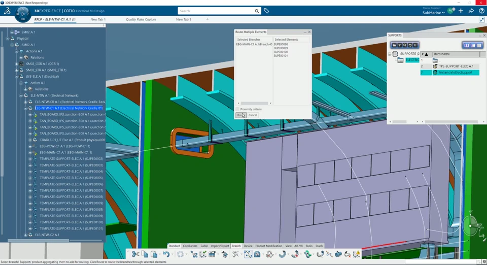

Automation
An EKL code allows to execute a multiple instantiation of this template :

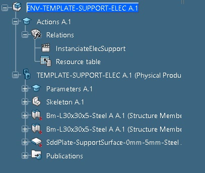

Content
The 3dxml contains :
  • TPL-SUPPORT-ELEC : Engineering Template
  • ENV-TEMPLATE-SUPPORT-ELEC : Action rule for automation + model of the template
