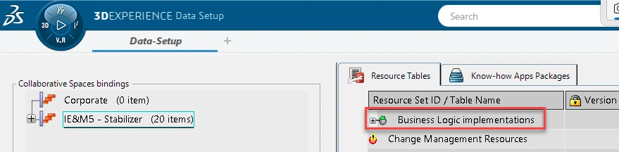

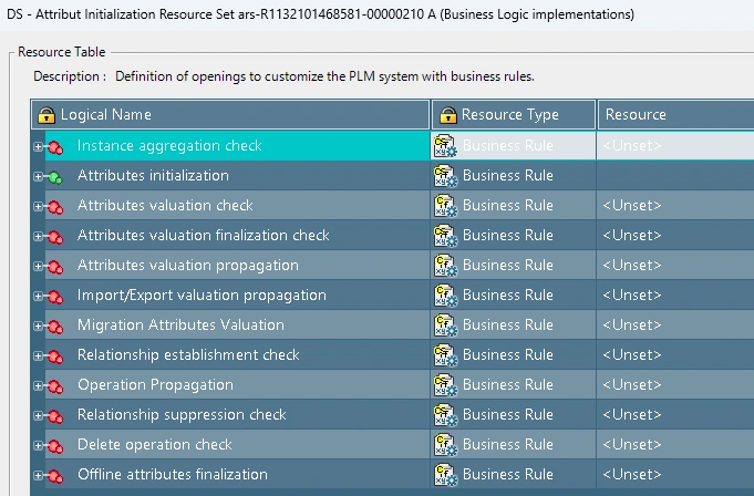

BUSINESS RULES
here is an exemple of Code to implement into the BL initialisation resourceSet to be able to maintain the instance name when moving the instance inside the product structure
--> TO COME
