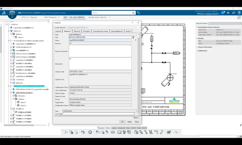

Rule Exemple2:
Description
There is a Business Rule that allows you to Compute the List of Piping Specification Following the Context (PipSpecListPipingSpecifications)
On this example, the list of specification is selected based on the system attributes :
Video

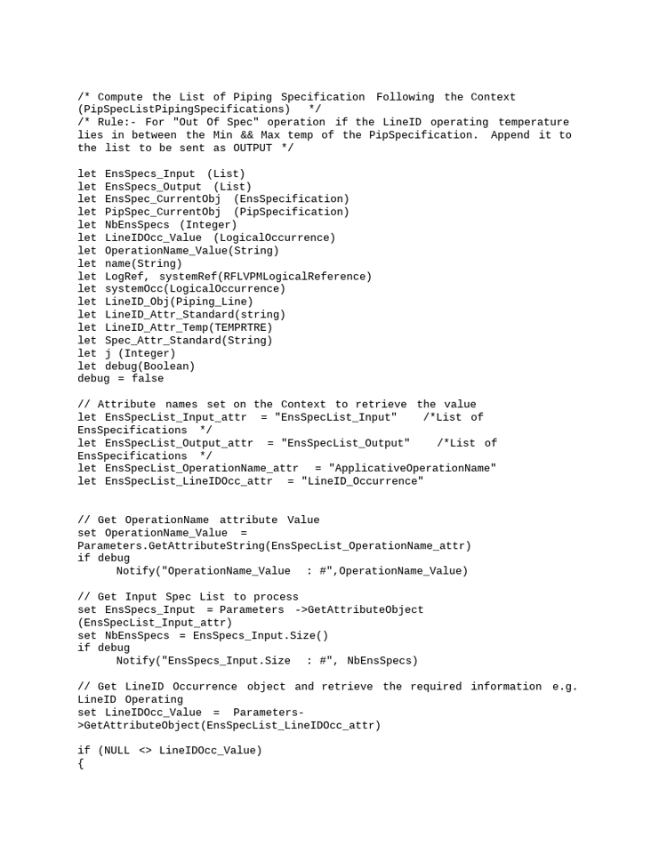

Code:
/* Compute the List of Piping Specification Following the Context (PipSpecListPipingSpecifications) */
/* Rule:- For "Out Of Spec" operation if the LineID operating temperature lies in between the Min && Max temp of the PipSpecification. Append it to the list to be sent as OUTPUT */
let EnsSpecs_Input (List)
let EnsSpecs_Output (List)
let EnsSpec_CurrentObj (EnsSpecification)
let PipSpec_CurrentObj (PipSpecification)
let NbEnsSpecs (Integer)
let LineIDOcc_Value (LogicalOccurrence)
let OperationName_Value(String)
let name(String)
let LogRef, systemRef(RFLVPMLogicalReference)
let systemOcc(LogicalOccurrence)
let LineID_Obj(Piping_Line)
let LineID_Attr_Standard(string)
let LineID_Attr_Temp(TEMPRTRE)
let Spec_Attr_Standard(String)
let j (Integer)
let debug(Boolean)
debug = false
// Attribute names set on the Context to retrieve the value
let EnsSpecList_Input_attr = "EnsSpecList_Input"   /*List of EnsSpecifications */
let EnsSpecList_Output_attr = "EnsSpecList_Output"   /*List of EnsSpecifications */
let EnsSpecList_OperationName_attr = "ApplicativeOperationName"
let EnsSpecList_LineIDOcc_attr = "LineID_Occurrence"
// Get OperationName attribute Value
set OperationName_Value = Parameters.GetAttributeString(EnsSpecList_OperationName_attr)
if debug
    Notify("OperationName_Value : #",OperationName_Value)
// Get Input Spec List to process
set EnsSpecs_Input = Parameters ->GetAttributeObject (EnsSpecList_Input_attr)
set NbEnsSpecs = EnsSpecs_Input.Size()
if debug
    Notify("EnsSpecs_Input.Size : #", NbEnsSpecs)
// Get LineID Occurrence object and retrieve the required information e.g. LineID Operating
set LineIDOcc_Value =  Parameters->GetAttributeObject(EnsSpecList_LineIDOcc_attr)
if (NULL <> LineIDOcc_Value)
    set systemOcc = LineIDOcc_Value.Owner
    set systemRef = systemOcc.Reference
    if debug
        Notify("systemOcc : #", systemOcc.Name)
        Notify("systemRef : #", systemRef.Name)
    if (systemRef.HasAttribute("Asset Type"))
        EnsSpecs_Output.Append(EnsSpecs_Input.GetItem(1))
        Notify("List of specification Filtered")
    else
        set EnsSpecs_Output = EnsSpecs_Input
        Notify("Full List of specification")
// Set the output
Parameters ->SetAttributeObject (EnsSpecList_Output_attr, EnsSpecs_Output)
txt file
