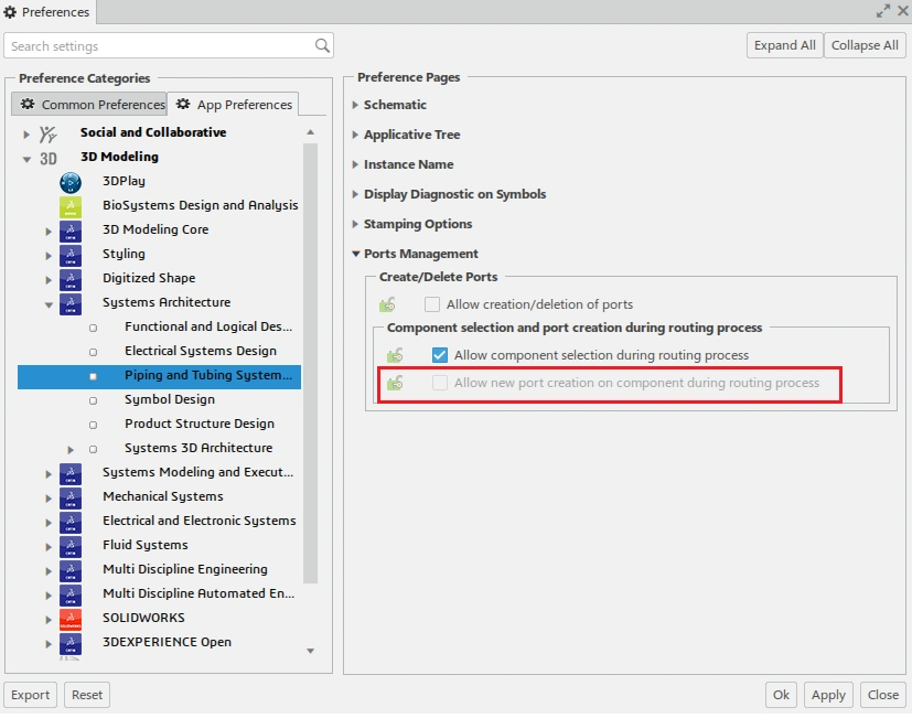

Note : Allow new port creation during routing process” should be unchecked as shown below.
Note - If the above setting is checked, Port Mapping Panel is always displayed even if only one valid port is found. No automatic selection in this case.
