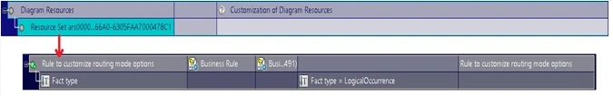

Datasetup Resource Set :
  • Diagram Resource
Datasetup Resource : Customizing routing mode options
EKL : Preference to restrict routing mode based on type and application (21xFD16LA - FUN118584) - (23xFD01 - FUN129668)
  • Variable : RFLP_ROUTINGMODE_PREF
  • New BL entry in datasetup Diagram resource

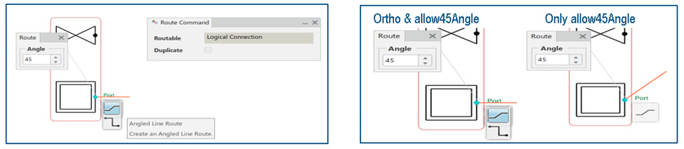

EKL : Customize available angle in angled mode
  • The customer can customize the angle of the Angled Route mode through the business rule for any routable objects like logical pipe, logical duct, cable, etc. and logical connection
  • The Business Rule “Schematic_CustomizeRoutingModes” is already present to customize routing mode options for different routable objects. Through this rule, user can customize the available routings modes for different types of routables.
  • In the existing Business Rule “Schematic_CustomizeRoutingModes”, a new output Boolean (Allow45Angle) parameter is added to customize the angle of Angled mode.
    • Parameters.SetAttributeBoolean("StraightMode", StraightModeAvailable)
    • Parameters.SetAttributeBoolean("AngledMode", AngledModeAvailable)
    • Parameters.SetAttributeBoolean("OrthoMode", OrthoModeAvailable)
    • Parameters.SetAttributeBoolean("Allow45Angle", IsFortyFiveAngleAllowed)
