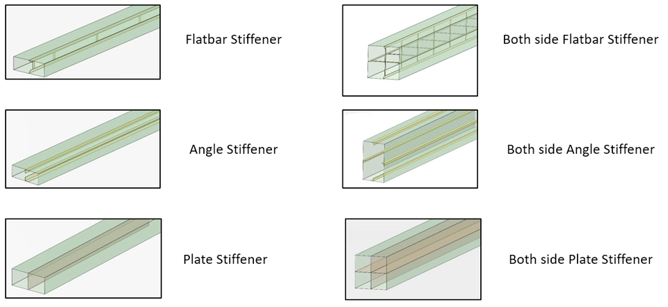

Two types of stiffeners which customer uses:

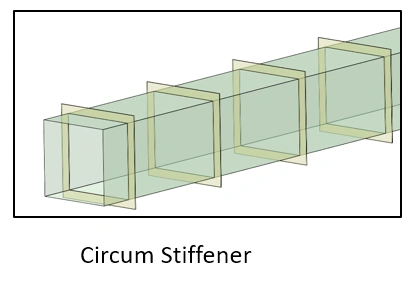

  1. Circumferential Stiffeners- They are placed along the circumference of HVAC duct and are dependent on length of the duct.
  1. Guide plate Stiffeners-     They are located inside the duct, directed along the length and dependent on width and height of the duct.
    • Flatbar Stiffener
    • Both Side Flatbar Stiffener
    • Angle Stiffener
    • Both Side Angle Stiffener
    • Plate Stiffener
    • Both Side Plate Stiffener

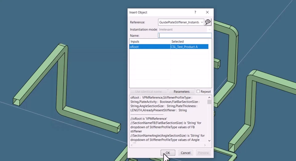

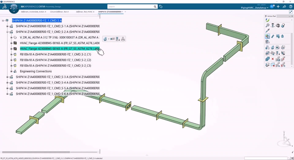

In order to create stiffeners on various ducts of different sizes, multiple Engineering templates depending upon stiffener types are modelled.
As customer does not have KAC role we could not create a customized UI to capture designer inputs. In order to work around this limitation and to enable creation of stiffeners in single click we provided commands, depending upon stiffener types, using “Action as a Command” functionality.
  1. Commands for Circumferential Stiffeners.
  2. Commands for Guide plate Stiffeners.
 Provided solution reduces time required in placing multiple stiffeners.
