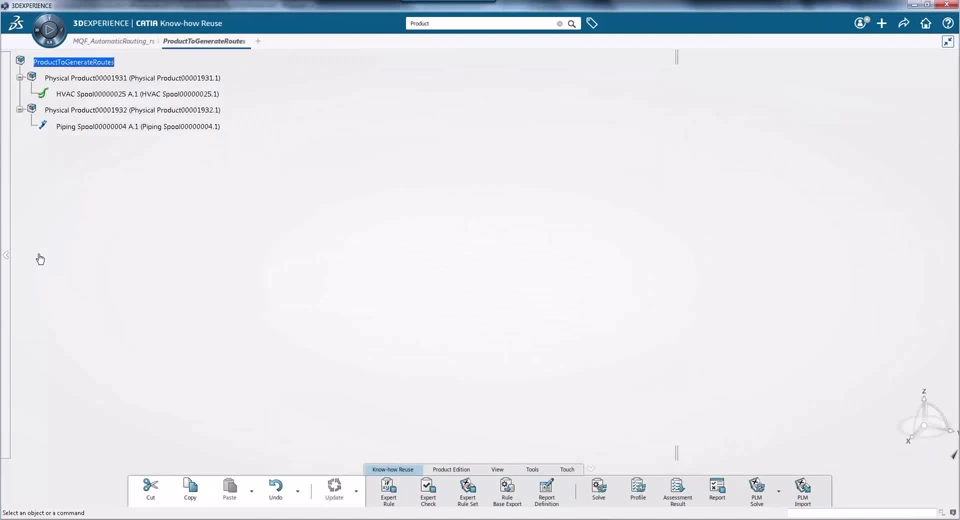

In this demonstration, we use :
  • an xml file containing the definition of 3 HVAC ducts and 1 pipe, definition in terms of nodes position, size (width, height, wall thickness), section shape, and orientation for the HVAC duct, and just size (outside diameter & wall thickness) for the pipe.
  • an Expert Rule containing an EKL script to read the xml file and translate the information contained in the file into a structured data supplied to the different EKL methods to generate the duct and pipe parts.
  • a product containing a HVAC Spool and a Piping Spool in which the duct and pipe parts will be automatically created.
The choice of Expert Rule to generate the ducts and pipes is motivated by the fact that it could be run in batch mode (KnowledgeExpertReport batch), allowing to process files containing the definition of hundreds of pipes, ducts or raceway trays.
