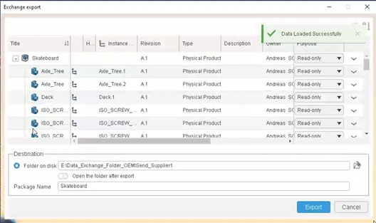

The OEM launches the Export command from the MySession Action bar on the data, he wants to export.
 The OEM defines access rules (Read-only, For Edit, Exclude) for each data to export.
In export panel, for each object, “Purpose” field can be set to three values:
  • For Edit: Data will be put into export package and can be modified by the supplier.
  • Read-only: Data will be put into export package but is not supposed to be modified by the supplier. This is the purpose set by default in the export panel.
  • Exclude: Data will not be put into export package.

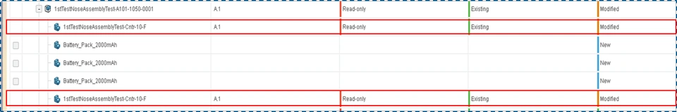

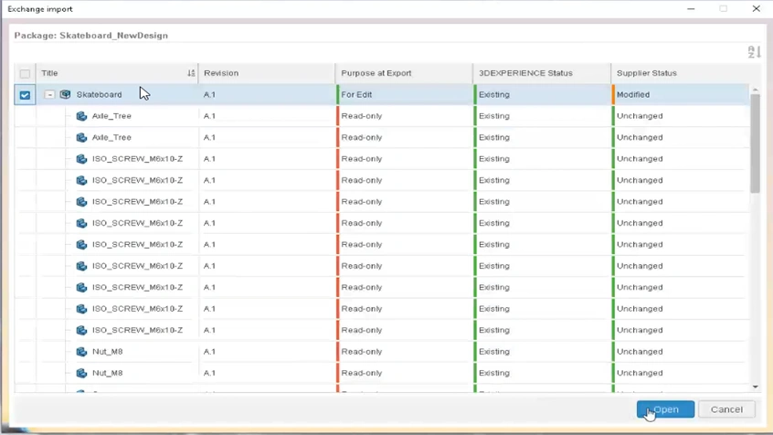

While importing the modified data from supplier to OEM, the import view is populated with several columns:
  • The Purpose at Export column containing the Purpose (access rule) for each data defined during the Export.
  • The Supplier Status column containing the Status of the data from the supplier package. There are four possible statuses: Existing/Unchanged, Modified, New, Removed/Deleted.
Automatic propagation on New Objects inside Import panel
  • Whenever a New object is selected its parent will also be selected.
  • Alternatively selecting an object aggregating a New object will automatically select this New object. This will ensure consistency for new objects.

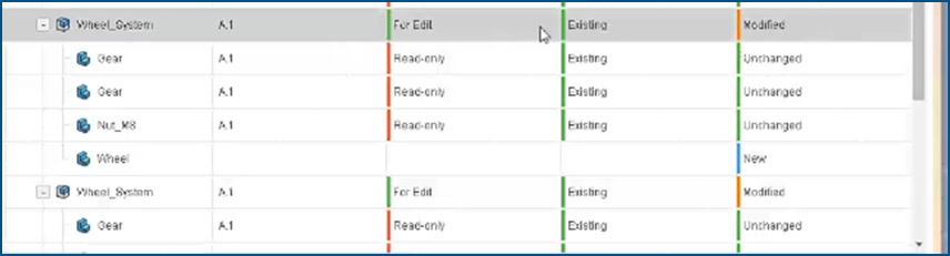

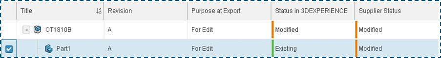

What happens if data has been modified by OEM in the meantime?
If data has been modified by supplier and also by OEM , data cannot be selected in import panel to avoid overwriting the data on the 3DEXPERIENCE side.

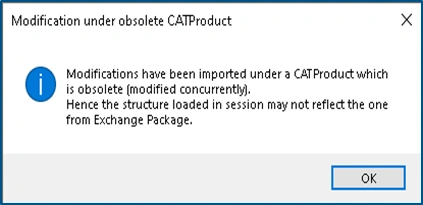

If children documents have been modified by supplier , those children will be selectable for import.
Such cases are valid but may be confusing to the user because modification done by the supplier on selected children are actually mounted in session at the end of import, but not the structure defined on their CATProduct parent. The below warning is then displayed at the end of import command:
What happens if data sent as Read-only are modified by the supplier?
If data sent as Read-only has been modified by supplier, data cannot be selected in import panel to avoid overwriting the data on the 3DEXPERIENCE side.

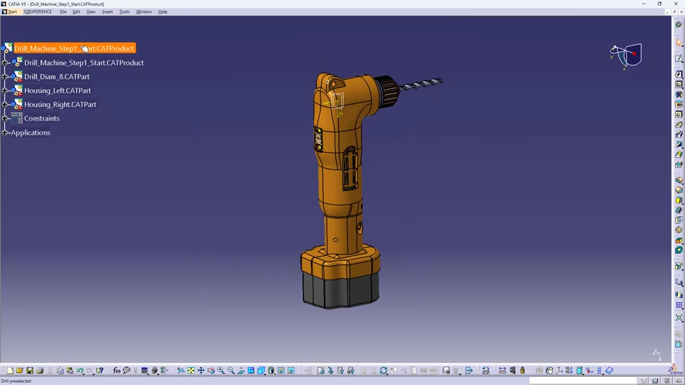

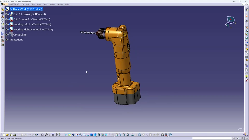

Step 1: OEM Exports Data from CATIA V5

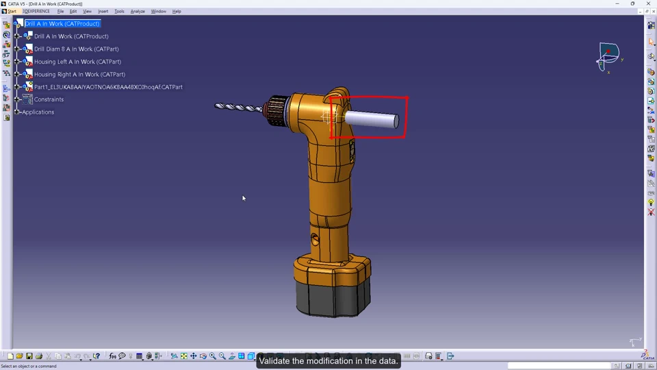

Step 2: Supplier Modifies the Data in CATIA V5
Step 3: OEM Imports the Modified Data to CATIA V5 and Saves it in the 3DEXPERIENCE platform
