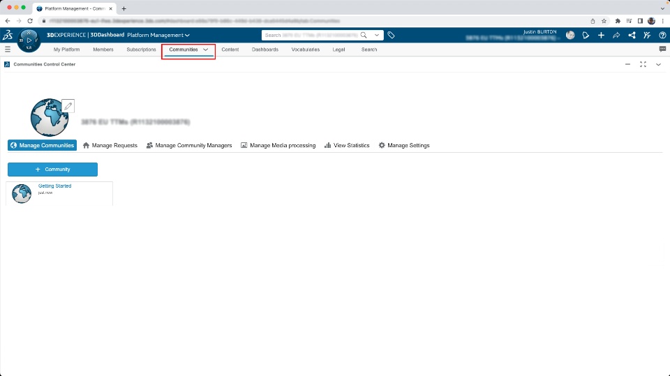

To access the Community options, go to the Platform Management Cockpit and select the "Communities" tab.
On this tab you will find the Communities Control Center application. Within the application there are 6 tabs to control and manage all of your platform communities.
  • Create new communities
  • Access community options for all communities on your platform
    • Members, Statistics and Settings
  • View and manage requests for new communities
  • View and moderate reports of community abuse
  • Add and manage platform 3DSwym community administrators
  • Platform administrators are automatically added a platform community administrators
  • View all media processing status
  • Restart, view logs, or download original media
  • View community statistics for all communities on your platform
  • Modify community settings that apply to all communities on your platform

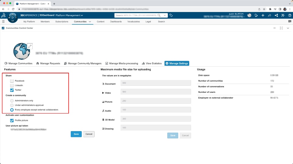

On the Manage Settings tab, we recommend taking note of the "Share" and "Create a Community" features
Share: Decide if you wish to allow or disallow community posts to be shared to an external social network
Create a Community: A common option is to allow members of the platform to created their own community (as shown in the video above). This setting does not allow external members to create a community.
