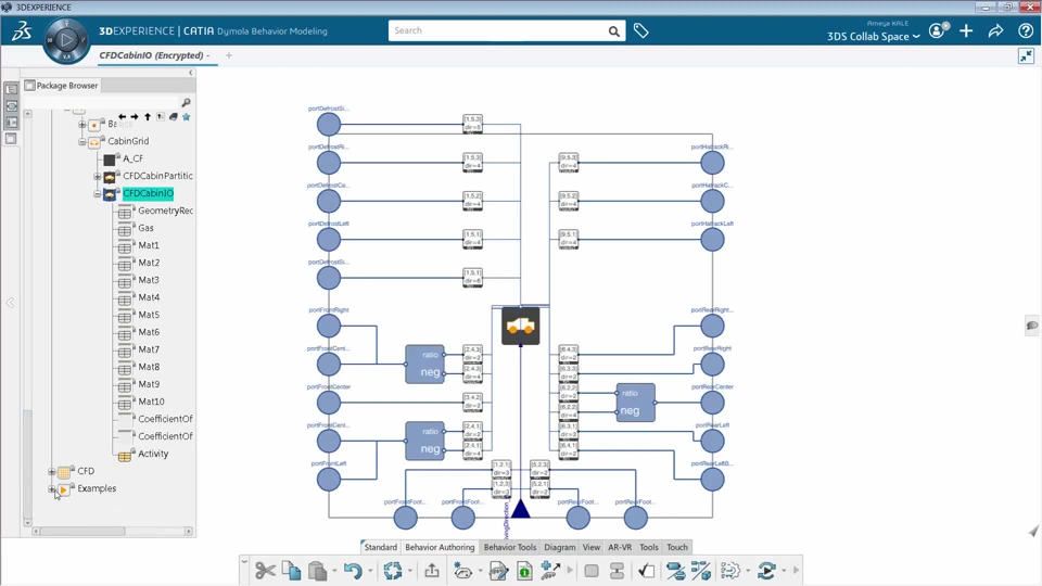

The Systems Fluid Dynamics library carries out CFD-Simulations using Modelica language and provides standard interfaces to 1D-Modelica-models for a seamless connection. The fluid dynamics are purely modelled by using Modelica language.
The Systems Fluid Dynamics Library allows the modelling and simulation of gas flows (e.g. humid air) in three-dimensional spaces. At the boundaries of the grid model local boundary conditions may be defined, which can change transiently or wall and window models can be attached. The maximum resolution of the cubic grid depends on the capacity of the computer hardware and is typically limited to about 1.000 - 2.000 cells. Larger spaces may even be modelled through the definition of symmetry boundary conditions.
