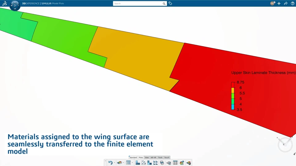

Fast definition of stiffener positions on a panel and easy definition of iso-thickness zones of composite materials on a skin

Composites Laminate definition matching with various needs of the maturity of conceptual studies: thickness and percentage per orientation (Thickness Ratio), number of layers per orientation (Thickness Law) or number of layers and corresponding order in the stacking (Stacking Sequence)
All in one command (Quick Grid) to split a surface in regions and assign laminates at the same time. Dedicated geometric commands are directly available in the Quick Grid command, allowing for an easy and on-the-fly creation of regions to be assigned with laminate definition.
