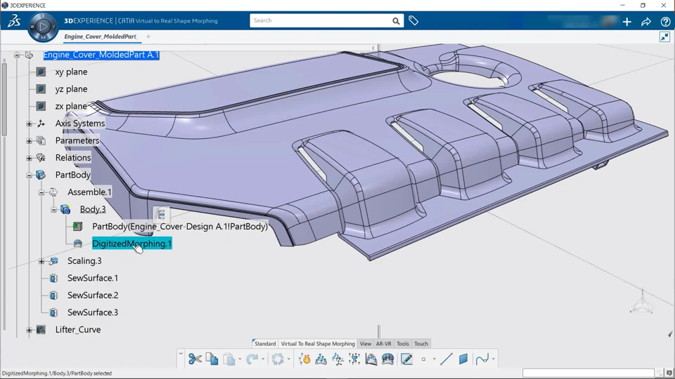

Reverse Shape Optimizer
Import and optimize clouds of points and STL data, create and refine meshes.
Create virtual shape from simulation computation or digitization results.
Compare nominal shape with predicted or real shape and measure deviations.
Update and optimize nominal shape by applying or compensation difference.
