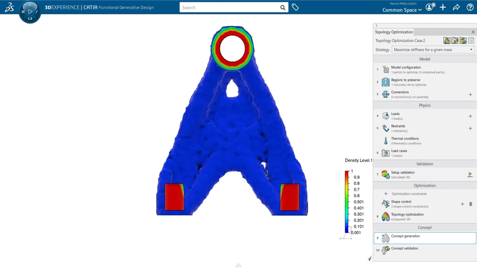

Design space creation from any CAD data, native or imported, edited using de-featuring and other intuitive direct modeling capabilities.
Clearly identified Functional regions remaining the same throughout the design exploration
Comprehensive sets of loading and boundary conditions to precisely specify what the targeted design shall withstand.
Extensive Optimization setup capabilities, including frequency, displacement or stress constraints as well as manufacturing constraints
Additive manufacturing support strategy exploration, thanks to overhang analysis and self-supported structures proposed for a given printing direction.
Automatic generation of a functional concept CAD
Alternatives creation from a baseline study, to explore different approaches, and then compare and assess their resulting mass and other Key Performance Indicators to select the best concept.
No need to re-define the simulation scenario: the initial setup is reused automatically on any generated shape, from concept to final, to structurally validate it.
