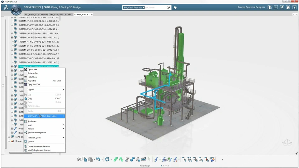

Automatically decompose 3D systems to individual piping and tubing objects, attributes, and relationships on the 3DEXPERIENCE platform.
The decomposition of piping and tubing objects, attributes, and relationships in the V6 database enables the customer to use standard database query and reporting tools. It allows data import/export using standard tools and formats, enables full PLM capabilities, manages changes and configurations, and offers powerful collaboration tools.

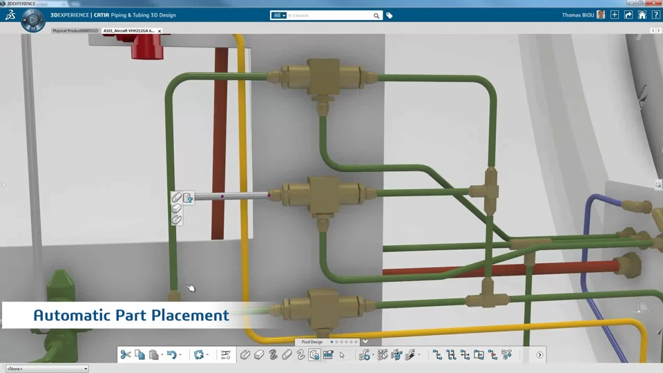

Function-driven piping and tubing part placement.
Users can capture the design intent for selected physical parts to ensure that modification scenarios are possible. Designers can layout and model a 3D piping or tubing network either manually or automatically. If parts are based on user-defined rules, such as branching or turning rules, much of the layout can be created automatically to optimize the total design process.
