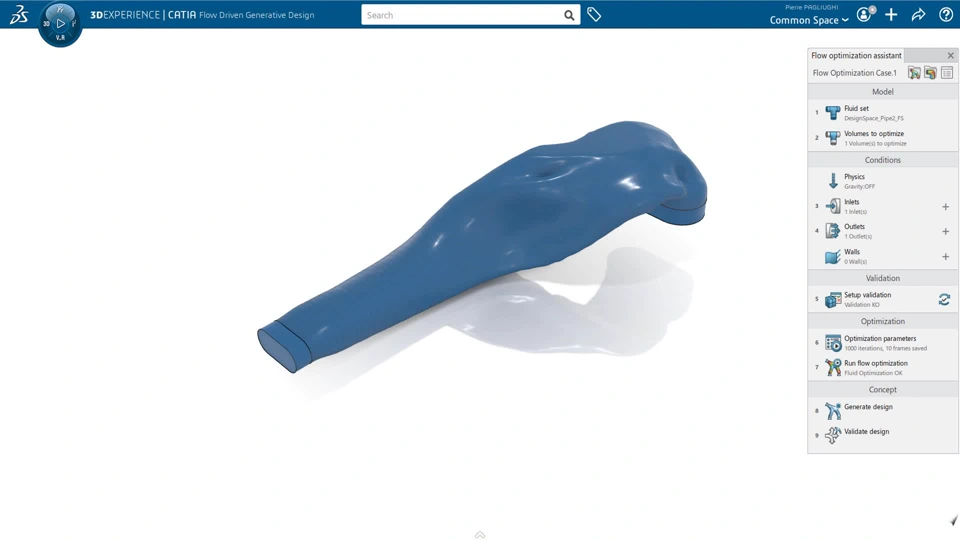

Improve the efficiency of internal fluid systems by generating shapes that respect performance KPI targets, via a streamlined & intuitive workflow experience.
Explore and Generate shapes for internal fluid flows that minimize pressure drops and preserve the mass flow rate (HVAC, cabin comfort systems, etc.)
Generate automatically flow-driven shapes, validated with an easily set-up RANS (Reynolds-averaged Navier-Stokes) CFD simulations
Promote a seamless collaboration between Design and Simulation departments
Benefits
Generate shapes for internal fluid flows minimizing pressure drop and preserving the mass flow rate (HVAC, cabin comfort systems, etc.)
Efficient Product Engineering, removing bottlenecks that usually make it cost-prohibitive to explore optimized parts.
Intuitive workflow for Design Engineers to guide through the RANS CFD and optimization setup
Automatic generation of flow-driven shapes and easy Design preparation functions
Seamless Collaboration with Design and Simulation departments
Embedded Compute up to 8 cores
Highlights
Workflow assistant to guide the user in every step of the process
Design space creation from any CAD data, native or imported, edited using de-featuring and other intuitive direct modeling capabilities.
Comprehensive sets of loading and boundary conditions to precisely specify what the targeted design shall withstand.
Account for filters in the fluid thanks to the addition of porous media
Topology Optimization setup capabilities leveraging optimality criterion
Automatic generation of a concept CAD with dedicated functionalities for pipe geometry creation.
Compare concept shape flow performances leveraging Key Information computation such as pressure drop, mass flow rate, mass flow balance etc…
No need to re-define the simulation scenario: the initial setup is reused automatically on any generated shape, from concept to final, to validate its fluid flow performances.
Improve the performances of generated shapes with embedded Parametric Optimization capabilities tailored for Flow-Driven Generative shapes
