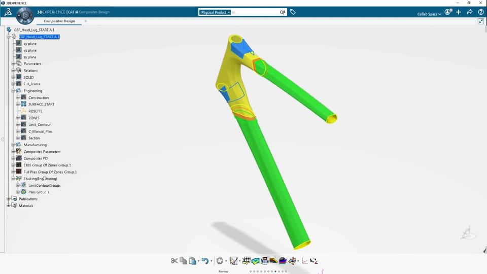

The Consumer Product Composites Designer role offers a wide range of tools specialized for designing composites structures. The role offers robust design methods, dedicated to capturing both design intents from stress department as well as the context of assembly, while also considering the manufacturing process and its associated constraints. This conceptual to detailed design approach fully matches with the design practices of the composites industries, from the ‘ply by ply’ approach for simpler part, to the ‘grid’ approach for more complex stiffened structure.
Dedicated tools helps the composites design engineers to integrate with other disciplines (numerical sizing and manufacturing) and to produce the expected data while the design reaches its final maturity (conceptual solid, refined ply contours & properties, 3D Sections, weight estimation, etc.). At all stages of the design process, the manufacturability of the parts can be easily assessed with fiber simulation for hand layup or for fiber placement/tape laying, ensuring the release of a producible composites part with regards to the targeted manufacturing process.
The Consumer Product Composites Designer role is fully integrated with the Consumer Product Composites Manufacturing Engineer role dedicated to the preparation of a composites design into a producible part, and all the data of a composites design model can be consumed by the simulation products of the 3DEXPERIENCE platform in order to perform structural validation.
