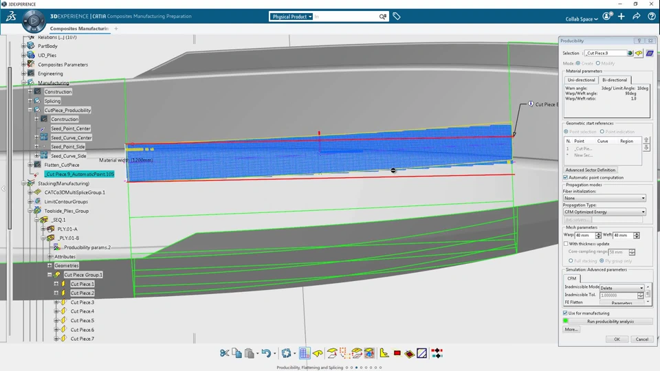

The Composites Manufacturing Engineer for Marine and Offshore role helps to transform the engineering models into producible parts, accounting for the constraints of the targeted manufacturing process. The effect of geometrical features and material parameters is easily predicted with producibility analysis for hand layup or for fiber placement/tape laying, reducing the need of costly prototypes and minimizing iterations with the shop floor.
The composites parts to be manufactured can be created within the Composites Manufacturing Engineer for Marine and Offshore role from a set of basic plies modeling features. For more complex parts, the engineering models that are created with the Composites Designer for Marine and Offshore are simply reopened with the Composites Manufacturing Engineer for Marine and Offshore role. The two roles are fully compatible, allowing the manufacturing model to be synchronized with the engineering model at all times.
As the manufacturing preparation converges toward a finalized and industrialized composites part, the manufacturing engineer has the capabilities to calculate flat patterns and export all the necessary output needed by the shop floor.

  • Robust surface modeling tools along with dedicated tools to prepare composites data for manufacturing.
  • Advanced Producibility Analysis with fiber simulation for Hand Layup and Fiber Placement.
  • Create flattened ply data from producibility analysis for accurate 2D shapes.
  • Create manufacturing ready composites data with dedicated features (3D Multi-Splicing, Darts, No Splice Zone, Butt Splice Zone,…)
