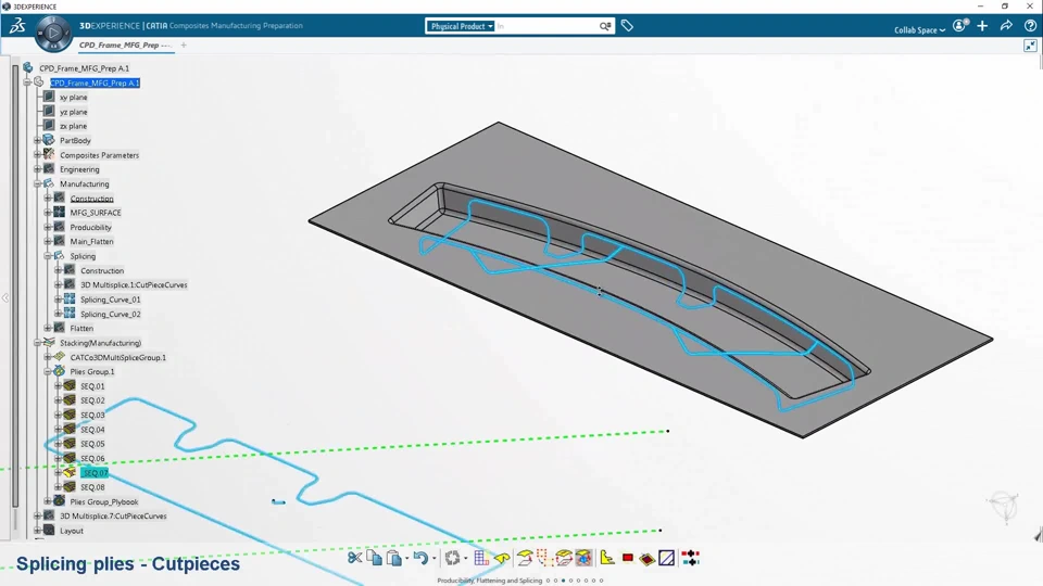

Create manufacturing ready composites data with dedicated features (3D Multi-Splicing, Darts, No Splice Zone, Butt Splice Zone,…)
