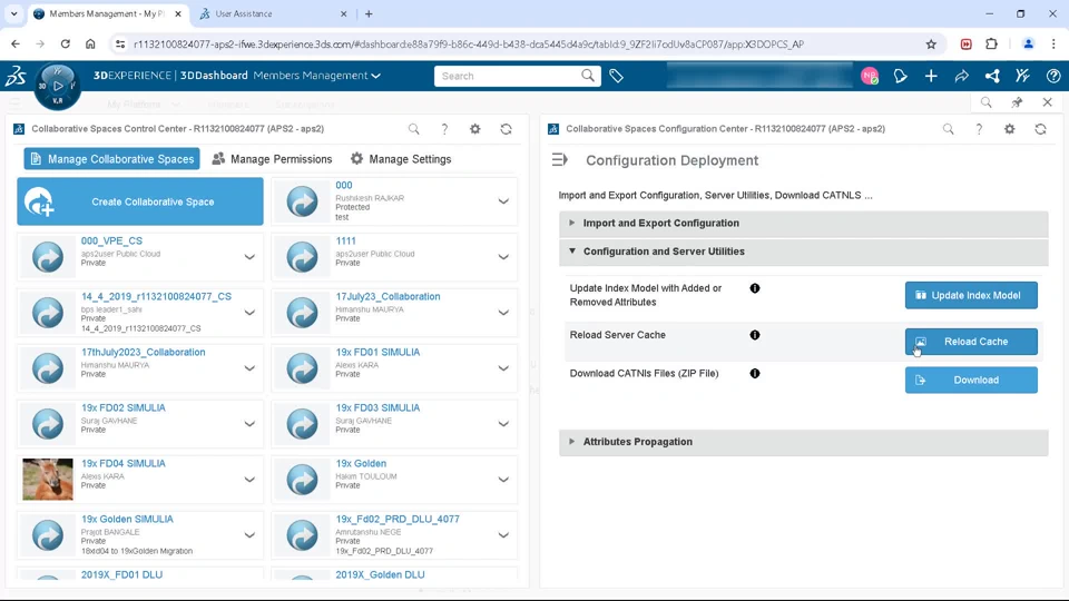

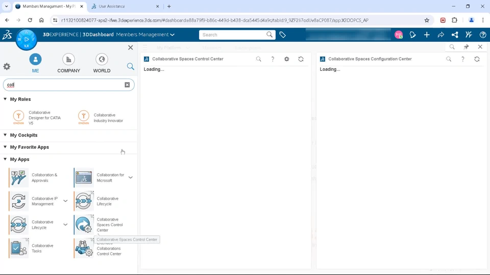

Step 1: Create Custom Attribute
Step 2: Configure Custom Attribute

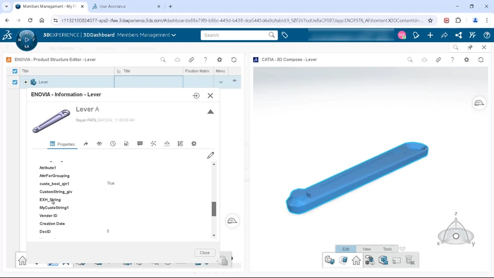

Step 3: View Custom Attribute in CATIA V5
Step 4: Populate Custom Attribute in the Save Dialog Box
- It is mandatory that the part should be first created in CATIA V5 then saved to the 3DEXPERIENCE platform. Any object created in the 3DEXPERIENCE platform does not open in CATIA V5
