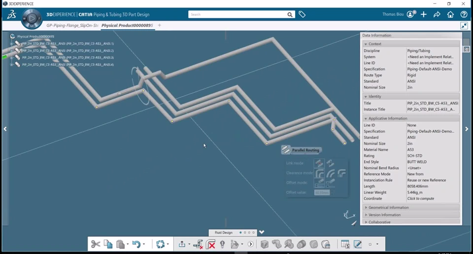

Objective is to route a pipe that follow another one
the parallele routing command allows to follow a full pipe or a portion of it with link or not

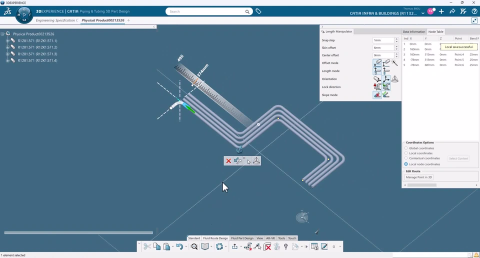

note : in some cases routing in "length manipulator" mode with offset will allows to get the same result except that you will not be able to have a link between the 2 pipes
