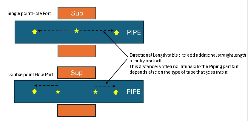

Ports:
Create a single Piping port either

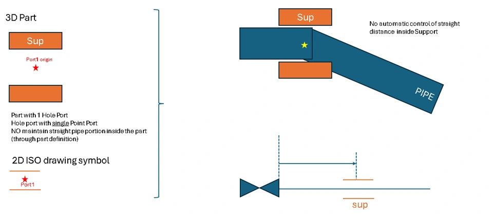

Single point hole port

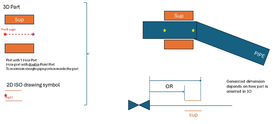

Double point hole port
Single vs double point port :
Double point port allows the have a given straight portion of pipe imposed by the support BUT the port origin will be located at one the this extremity . As consequence, in the Piping isometric drawing the dimension will indicate the support extremity position (not the center point)
Single point port DOES NOT allows the have a given straight portion of pipe imposed by the support BUT the port origin will be located at the part center . As consequence, in the Piping isometric drawing the dimension will indicate the support center position
Design rules

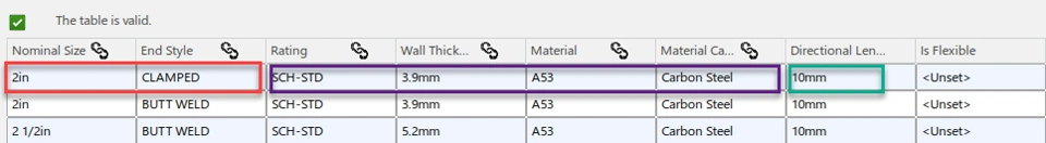

Additionnal straight length can be added through Directionnal length table.
For a given pipe size, this length will depends , on the couple Endstyle of the Piping part and Pipe caracteristics.
