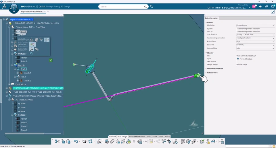

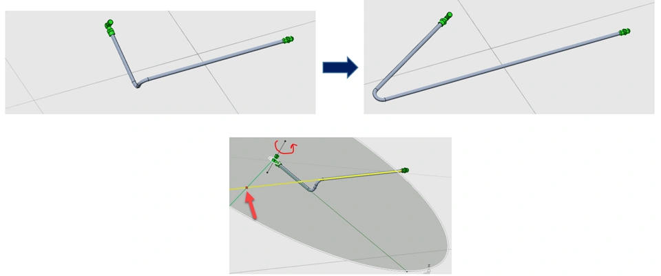

We want to optimize End fitting orientation to reduce the number of pipe bend
in the following exemple to go from one fitting to the other we have routed a pipe with2 bends . now we want to compute the pipe path between the 2 fittings but with a single bend and for this we are allowed to rotate the angle fitting
