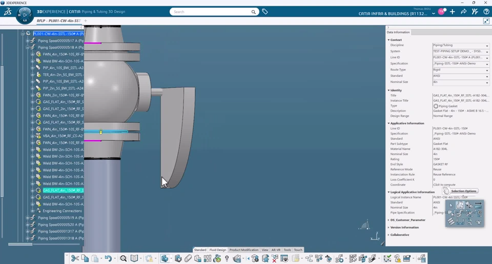

USE CASE1: check connection part & material spec compliancy
What is shown in the video:
- Chech that all piping part are connected each others
- Check that there is no missing gasket or fastener along the piping network
- Check that all the part are respecting Piping Line Material Specification
Prerequisite :
- having Piping material Specification defined with applicable piping parts (part filters)
- having Automatic Part placement rule table defined into the piping material specification
