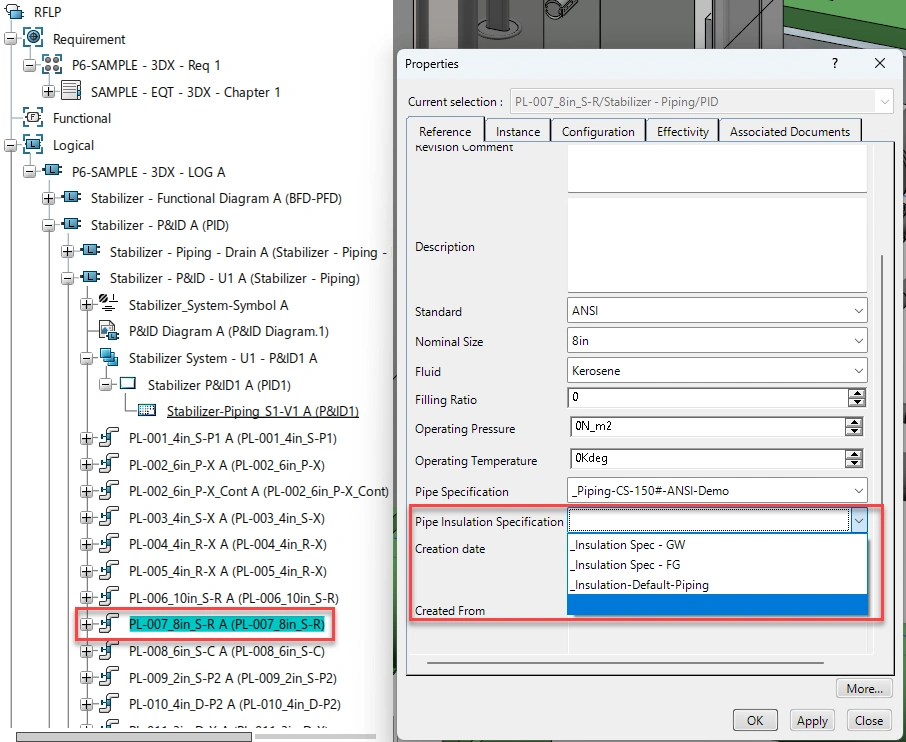

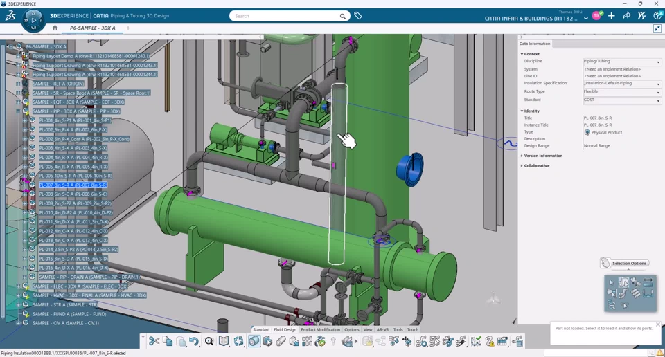

Manual placement of insulation
Piping design context

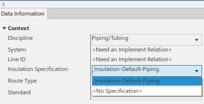

Working without LineID (so with single Default specification)
You will be able to select only the Insulation specification attached to the Default Specification Resource from Datasetup

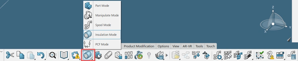

To be able to select a insulation specification in Data Information Panel, you must be in insulation mode

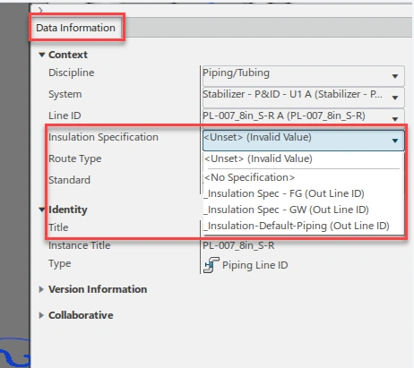

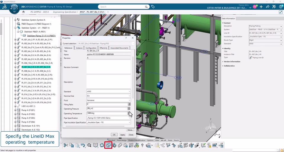

Working with lineID
Insulation Specification is retreive from LineID. in lineID you will have access to all Insulation specifiaction declared into the Insulation Specification Resource from Datasetup
At any moment you can override the insulation from lineID by selecting manually one in Data information panel

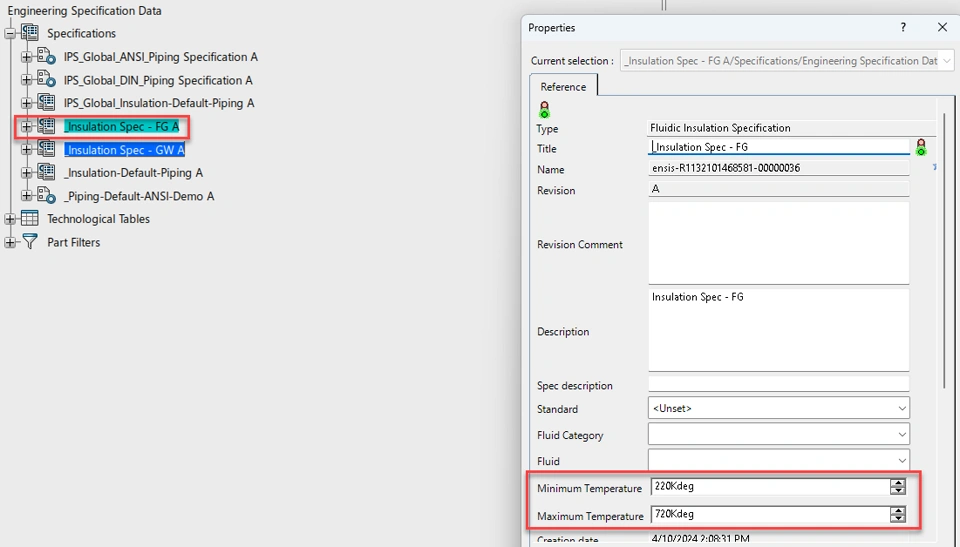

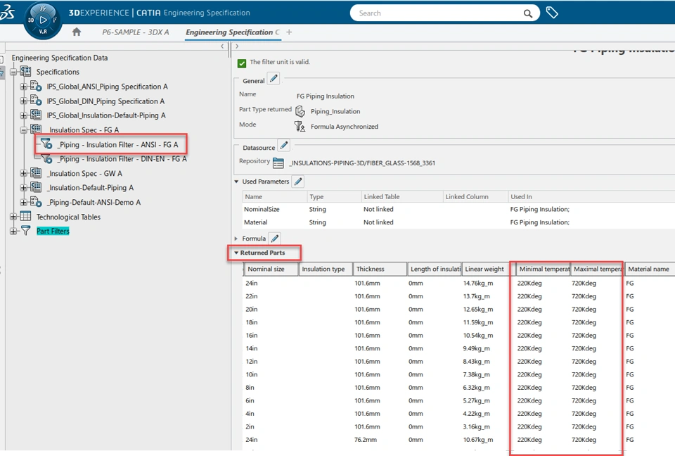

When working with lineID , the selection of the reference PArt are filtered based on the lineID Temperature --> be carefull to have a temperature on the lineID that is compatible with the Insulation Part Min/Max temperature
Not sure the value on insualtion spec has an impact
Very important to have value defined at insulation part level
