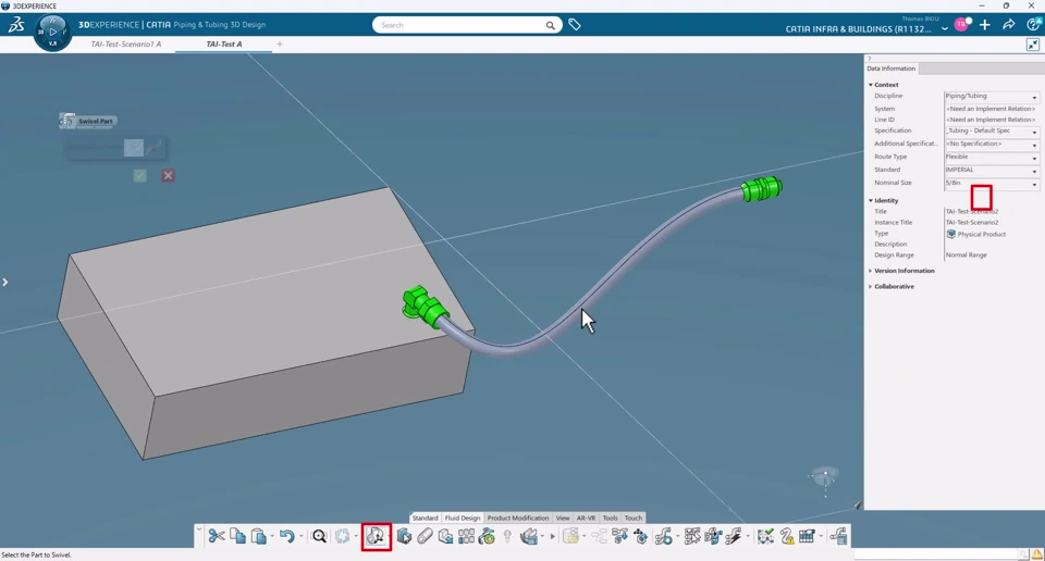

Swivel management of Flexible route
This command helps the user to minimize the torsionn in a flex route by rotating (swivelling) a angle part connected at its end
The functionality works on a Flexible tube having at least one end connected to a part/equipment. Swivel will be done on the connected part (if possible).
- If both extremities are connected to parts then swivel rotation can be done by the user on one part at a time.
- The Swivel part will be rotated along one of its port axes.
- The swivel part is rotated about the rotation axis so that the flex route must have the best possible shape i.e. with the least strain.

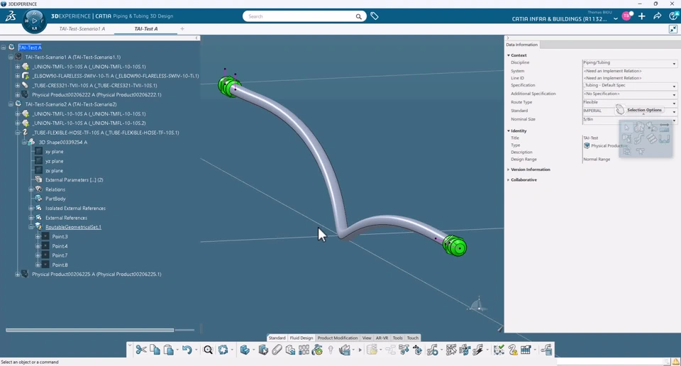

Usecases

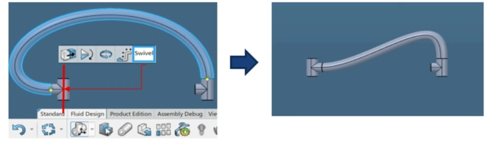

swivel management with angle fitting
Compute the optimized angle fitting orientation along selected axis to minimize the constrains (torsion) on the tube to reach the second tube etremity fitting

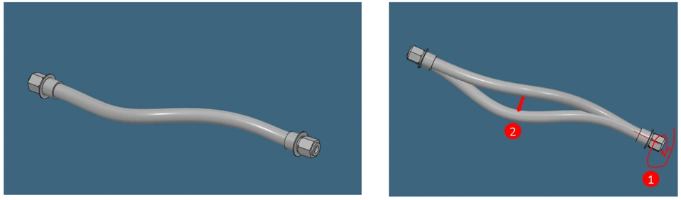

swivel management with straight fitting
As of today 2024x, Flexible tube command doesn't manage torsion between straight fitting and tube.
The swivel management command seems to not have been done to introduce additionnal torsion on the tube
