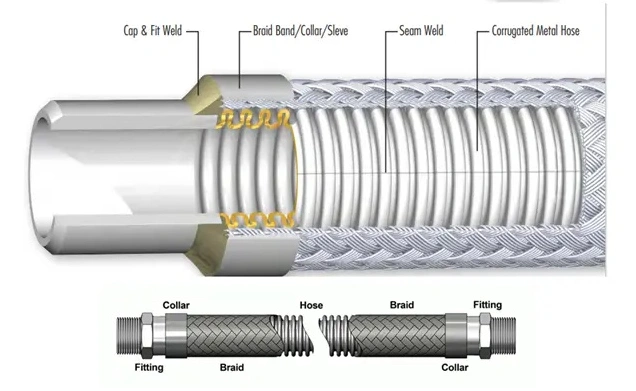

Normal Flexible hoses are made of non-metals like soft plastic material or synthetic rubber & they can have external reinforced metalic braid layers.
In some industry like chemical some of the hose used to absorb pipe movements are fully made of metallic materials.

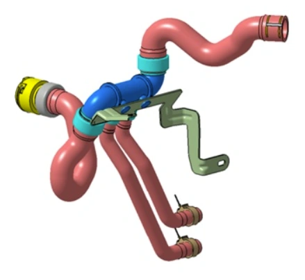

Create Hose
Designing flexible tube involves different step :
  • Select the system to work on
    • fluid, operating conditions (temperature, pressure)
  • Selecting the good tube reference
    • sizes, material, minimum bend radius
  • Define the path of the tube
    • Extremity connections
    • Intermetiate fixed parts along the route (supports)
  • Defining the the initial tube constrain
    • slack, length .
  • Defining additional parts that are attached to the tube (follow the tube, not fixed)
    • protection, insulation
    • load parts
From this input the design tool should calculate the more realistic shape.

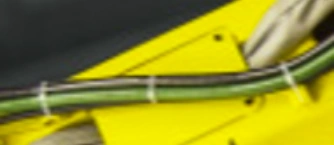

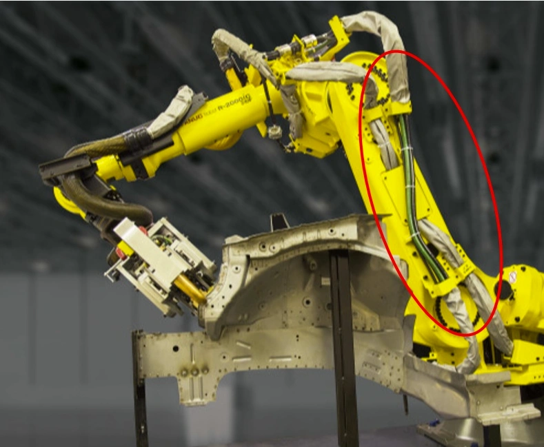

it can happens that hoses are routed alone but in many cases they are regrouped in bundle on some portion using strips and/or tape and/or protection.
In this case, in real life, the tubes will behave as a unique  flexible object which will have different property (resulting from each of the internal element). This case is very difficult to simulate because it request to know the physical properties of the bundle
To increase the complexity for realistic simulation, Bundles can be composed on a mix of tubes and cables.

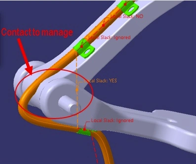

the increase complexity, the tube/bundle can be constrain along their rout by other external elements
Along the tube locally
The hose or bundle can go though different elements that will constrain it position and possible movement differently.
  • A clamp support  will completely constrain the hose on a fixed element
    • the tube center curve is constrain by the point position
    • the length of the tube portion before and after will be always the same.
  • a fixed guide will leave some degree of fredom
    • the tube center curve is constrain by the point position (port on the guide)
    • the tube can slide inside the guide --> the length of the tube portion before and after can change during the assembly motion.
