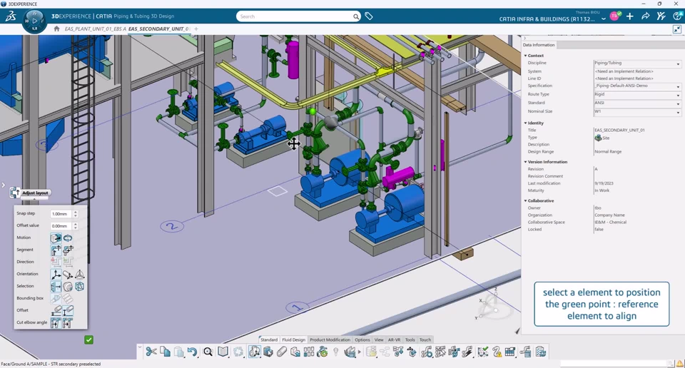

when manipulating network user don't want to have to think about how the links have been created and the nature of the links, it is why we have a dedicated command  for that in Piping/HVAC App ; called Adjust Layout
Note ; if you use the Translate or rotate command from piping App the behavior will be similar to the default behavior common to all CATIA objects. only Adjust layout has dedicated behavior
The command is very power full but can be a little tricky to use for begginers because you have many options in it, let see in the following videos some exemple of usage

Align Pipe segment / branch with another element
switch to alternate position
Align Pipe segment including insulation thickness and/or safety marging
